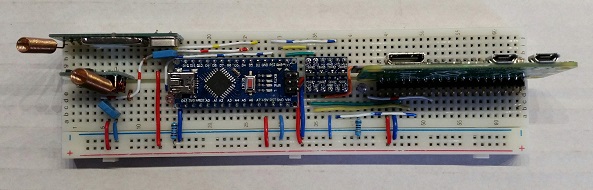

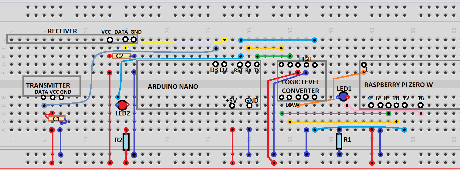

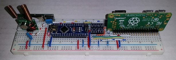

This is what you make (breadboard):
Or compact on a development print-board:

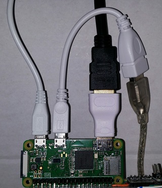

Connect the Raspberry Pi Zero W to a monitor and an USB hub. You will need a microUSB adapter. For the monitor you will need a mini HDMI to HDMI adapter.
Place the SD-card in the Raspberry Pi Zero W and power on.

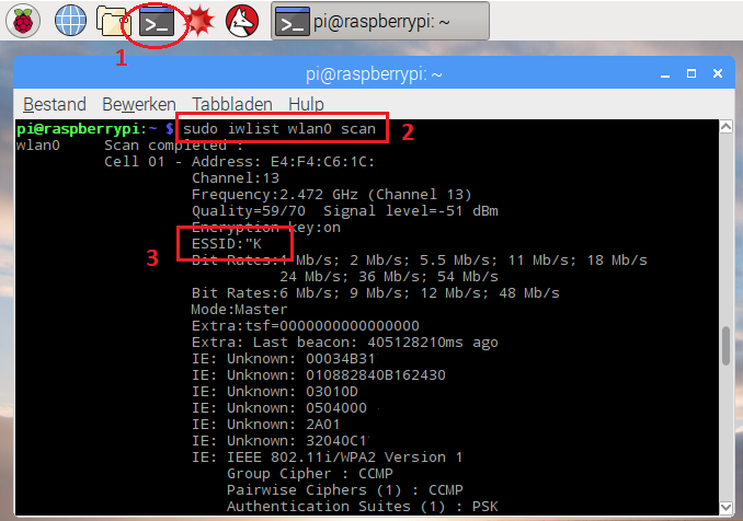

- Open a command shell
sudo iwlist wlan0 scan
- Look for your network in the list. Make a note of the name behind ESSID:
sudo nano /etc/wpa_supplicant/wpa_supplicant.conf

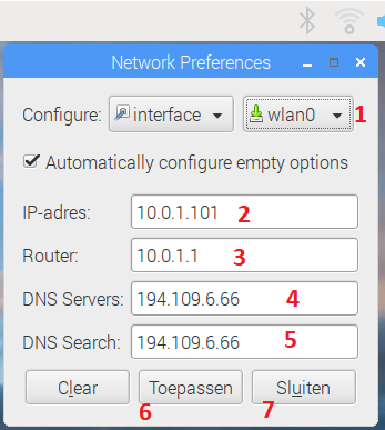

--> Click Right --> Wireless & Wired Network Settings
--> Select your network
--> Network Preferences --> Interface --> wlan0
Fill the empty fields:
IP-adres --> 192.168.0.123 (choose a suitable IP-address in you IP-range)
Router --> 192.168.0.1 (The gateway from your network to internet)
DNS Servers --> 194.109.6.66 (The DNS server of your internet provider)
DNS Search --> 194.109.6.66 (The DNS server of your internet provider)
- Save and reboot
- You should now have a working internet connection.

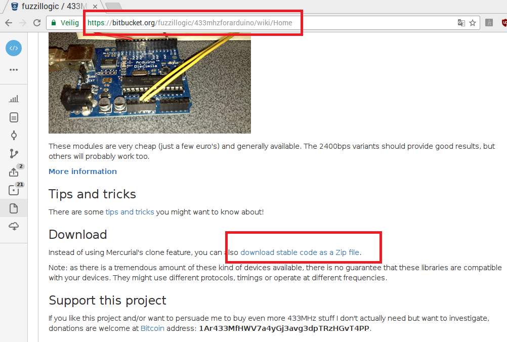

In a browser, open:
https://bitbucket.org/fuzzillogic/433mh ... /wiki/Home
For typing, note: fuzzillogic is with two l's; Home is with large H.
- Download:
https://bitbucket.org/fuzzillogic/433mh ... stable.zip

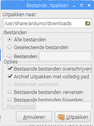

- Open the downloaded zip-file
- Unpack to /usr/share/arduino/downloads
- with explorer, go to /usr/share/arduino/downloads
- open folder fuzillogic-433mhzforarduino-e8eff1271a01
- click right on folder NewRemoteSwitch (don't open) --> choose copy
- go to folder /usr/share/arduino/libraries
- right click --> paste

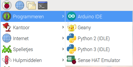

See if you can find the Arduino IDE:
- Click Raspberry Icon --> Programming --> Arduino

Domoticz on 30 Euro hardware - Build the hardware
So you need:
- 1 x Raspberry Pi Zero W
- 1 x 20 pin 90 degrees connector
- 1 x 20 pin 90 degrees connector with long legs (or straight long pins)
- 1 x Arduino Nano (clone)
- 1 x Level converter 4 channel
- 1 x 433 Mhz Receiver
- 1 x 433 Mhz Transmitter
- 2 x Capacitor 100 nano Farrad
- 2 x resistor (about) 1 kilo Ohm
- 1 led Red
- 1 led Blue
I suppose you will start on a breadboard.
This is your scheme:
And this is what you should get:
And you could even try powering it on. After a short period the blue led should be lit to indicate that the Raspberry Pi is active.
