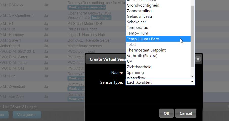

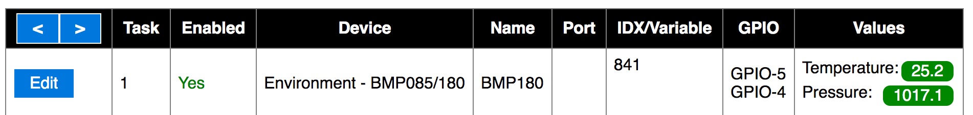

Hi, i have a same problem i think.
I added a Temp + Baro device but only the Temp value is shown. I tried both the BMP180 and 280's. On my nodeMCU i can see both value's (see images)

fvdijke wrote:Hi, i have a same problem i think.
Use rules in ESPEasy to get it working:
To make ESPEasy work with Domoticz BMP280 sensor, disable the Send to controller for the specific device and;
add a rule in ESPEasy like the following:
On System#Boot do    //When the ESP boots, do
  timerSet,1,240      //Set Timer 1 for the next event in 240 seconds
endon
On Rules#Timer=1 do
  SendToHTTP,192.168.1.80,8080,/json.htm?type=command&param=udevice&idx=69&nvalue=0&svalue=[Barometer#Temperature];[Barometer#Pressure];BAR_FOR;ALTITUDE
  timerSet,1,240       //Resets the Timer 1 for another 240 seconds
endon
-- Comment: Where Barometer is the name of the device and #Temperature and #Pressure are the valuenames
-- Above will send updates every 4 minutes, hench the timer set
Hope this helps.

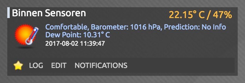

Is this a BMP related problem? My BME280 sensor works perfectly:
