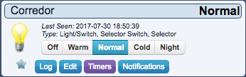

I have four lights in my corridor and created a simple bash script:
#!/bin/bash
cd /home/pi/domoticz/scripts/python/ikea-smartlight/
python tradfri-groups.py -a power -g 174716 -v $1
python tradfri-groups.py -a brightness -g 174716 -v $2
python tradfri-lights.py -a color -l 65537 -v $3
python tradfri-lights.py -a color -l 65538 -v $3
python tradfri-lights.py -a color -l 65539 -v $3
python tradfri-lights.py -a color -l 65540 -v $3
Which I am calling using a virtual switch (and with some simple timers depending on the hour of the day):
