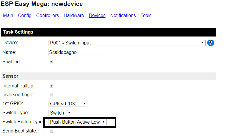

I have un update;
if I configure the switch in this way, it seems functioning
But if I select in "Switch Button Type" field the option " Normal switch" I have the problem.....why?
Raspberry PI 3, 3x Yeelight bulbs, 1x Yeeligh led strip, 1x Sonoff with ESP826, Controlicz, Kodi
