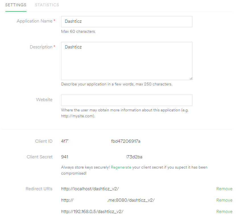

I got around this by opening Spotify itself once on the same machine..
But later I found I cannot get this to work in my Tablet using Fully Kiosk Browser. I keep seeing the "INVALID_CLIENT: Invalid redirect URL" error, even after I logged in op developer.spotify.com.
It would be very cool if we got this module to work, and extend a little (play music on other device!)
vgr2
Posts: 71
Joined: Monday 29 August 2016 12:02
Re: Dashticz - [BETA]Module - Spotify
Post by vgr2 »
barbaar wrote:I got around this by opening Spotify itself once on the same machine..
would be nice also for me......
robgeerts
Posts: 1273
Domoticz version: 3.7067
Post by robgeerts »
I assume you're using the same url on windows and tablet?
For example, some people are using http://localhost/dashticz on windows and http://192.168.1.3/dashticz on another device.

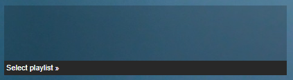

vgr2 wrote:Rob, now I have to loging to Spotify parallel, otherwise it will not work.
Hi vgr2,
How did you do to see your playlist finally? I have the button "show playlist" but no popup that opens anything?
Raspberry PI 2 whith Domoticz (Master)
Raspberry PI B+ whith Domoticz (Slave)
Raspberry PI B+ whith OSMC
RFLINK - ZWAVE - TELEINFO - 1 WIRE
vgr2
Posts: 71
Post by vgr2 »
Have you installed last beta?
konix
Joined: Wednesday 24 September 2014 8:40
Location: France
Post by konix »
vgr2 wrote:Have you installed last beta?
Hi vgr2,
I try again and now it's works ..... :roll:
D'rMorris
Posts: 138
Joined: Thursday 01 May 2014 9:01
Location: Netherlands - Sittard
Re: Dashticz - Module - Spotify
Post by D'rMorris »
Just so that it might help others: if you only created a Spotify account so that you could test this plugin (like I did), please be aware that you indeed first have to actually play something. I created an account, enabled the developer API, created 2 playlists, got the Spotify login page when refresjng Dashticz, but nothing showed when I clicked playlists. Then I installed the Spotify app on my Android tablet (from which I'm now accessing Dashticz), played a song and all of a sudden the plugin appeared in Dashticz!
