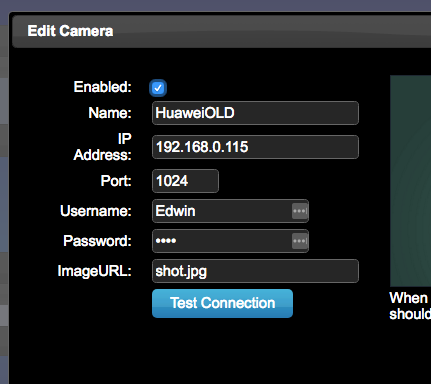

Which settings did you use in Domoticz? Because my Android camera's aren't connecting in Domoticz

This is what I have
Screen Shot 2017-05-23 at 21.56.51.png (40.27 KiB) Viewed 14673 times
Took some time to set it up on the phone side.

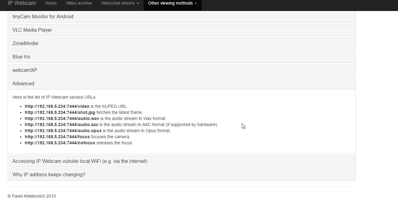

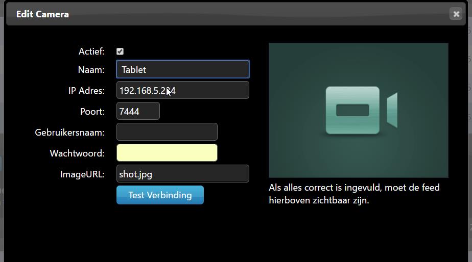

Derik
Posts: 1605
Re: cheapest IP camera
Post by Derik »
Type your phone ip and port:
There you have all options:
Search option/ :
Here you got some picture options..
And then in Domoticz choose the ood options:

Thanks for all the quick responses, now my camera's are working :)
