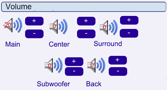

Domoticz is not very well suited to control audio video gear. For instance in order to control the volume one needs 3 controls (see picture). In a home theater environment, one needs to add 4 more buttons (center, sub, back, surround) that makes 8 controls in domoticz, 11 as a total. The interface would become clutered with many buttons and not very user friendly.
I think (and hope) that devs would consider to design some specific controls for A/V management. The first one would be for volume and could include 2 sub controls (Vol + and Vol -) and an optional control for mute (state of the mute button, i.e. icon, would change accordingly)
Does it make sense?
Does it make sense?

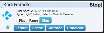

Re: Volume button
And what about selector?
- Bez názvu-1.jpg (26.11 KiB) Viewed 9606 times

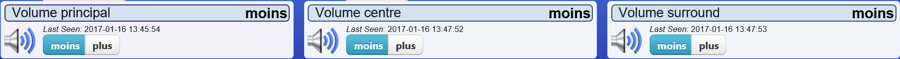

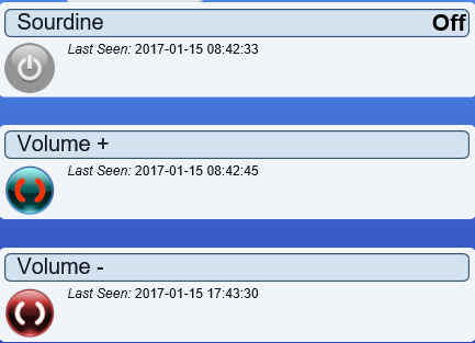

Re: Volume button
@michaldobrotka and @nizaga: thanks for your inputs. Selector switch is certainly a workable solution, I do use the selector in a number of situations. However I think this could be improved in order to have a more compact and user friendly control.
As such, one of the states of the selector remains selected with does not mean anything in that case (no big deal I must admit).
For the mute control, I sat-up a new On/Off button with a speaker icon. However the logic should be inverted (that is when Mute is on, the button icon should be off)
A control with all volume controls in it would be more user friendly (dont pay attention to the graphic design, the sole purpose is to illustrate the idea). Values in red represent the actual value of each channel.

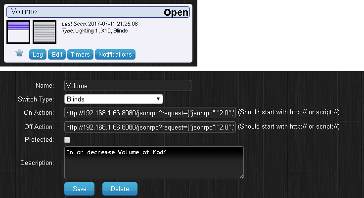

Re: Volume button
I use as Nizaga suggets the Switch Type "Blinds" to control Kodi. Works great !
URLs are the following...
http://192.168.1.66:8080/jsonrpc?reques ... t"},"id":1}
(change IP adres and id to your own values)
The volume is in or decreased with 5 units.

If you run the latest beta, you can use LUA to capture the stop event and program your action. In the current stable is not implemented but in the latest beta is working fine. I use the on action/off action via URL and the stop via LUA
