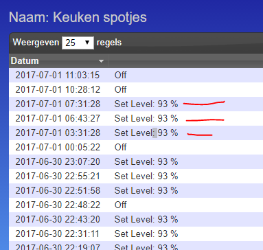

Is it possible that a blocky event is stil active/present if the event as been deleted?
At our place, the kitchen light sometimes go to on state while the presence sensor is off.
I replaced the Kaku (Klikaanklikuit/Coco) actor, with no result, the log shows that the licht is switched on from Domotics
but is not switched on by an active event.
I think it is possible that an old Blocky event is stil present somewhere, allthought i can't see it.
If that is thrue, in which directory or file are the Blocky events stored?

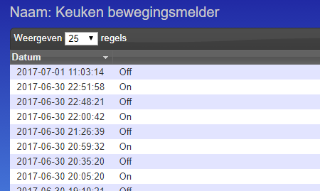

PS, update 11:50
It looks like the presence sensor is not always switching to OFF
This Aeon Labs Multi Sensor presence sensor is not always reliable on battery's, maybe is should replace it or put an adapter on it.
Tips are stil appreciated
Status kitchen light:

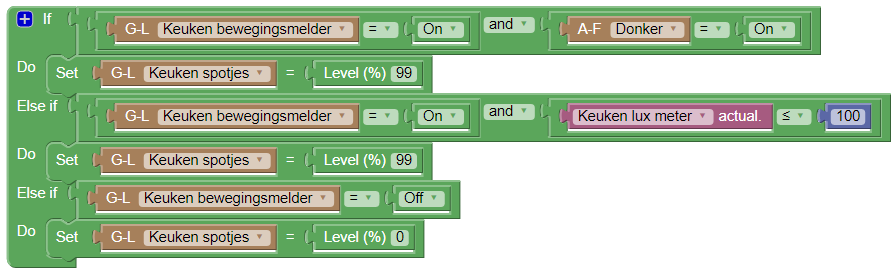

Blocky event:
In the event i used a Set Level 99% state on purpose.
If a Kaku dimmer switch is set to ON for a second time by the presence sensor in case the dimmer was already on
the lights start to dim from min-max-min-max just likt klikking two times on the actual switch.
