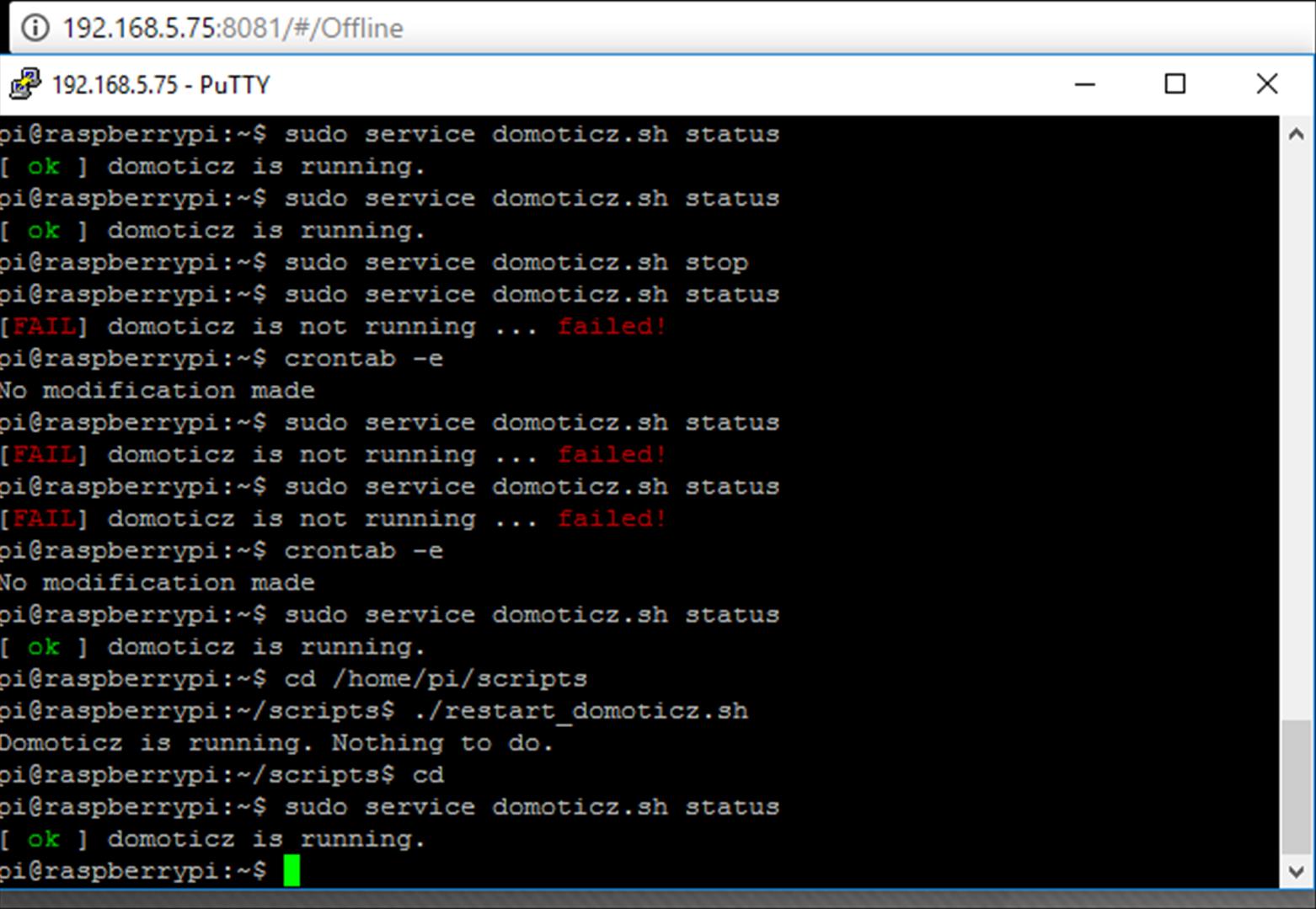

Hope some one can help me...
Do have a script to reboot the Pi.
With a Cron:
Only a strange thing...
With the cli the pi is thinking it is running.
Only my webgui says offline...
Is there a solution for.???
#!/bin/bash
DomoticzState=`sudo service domoticz.sh status`
if [[ $DomoticzState == "domoticz is running." ]]
then
echo 'Domoticz is running. Nothing to do.'
elif [[ $DomoticzState == "domoticz is not running ... failed!" ]]
then
echo 'Domoticz is not running. Restarting Domoticz...'
sudo service domoticz.sh restart
echo 'Domoticz restarted.'
fi
*/2 * * * * sudo /home/pi/scripts/restart_domoticz.sh With the cli the pi is thinking it is running.
- ScreenShot008.jpg (156.54 KiB) Viewed 8200 times

Re: Script to restart Domoticz if it crashes
Look at the scripts provided earlier in this topic.
Derik
- Posts: 1605
- Domoticz version: BETA
Thanks for the great help..Egregius wrote:Look at the scripts provided earlier in this topic.
Perhaps it is the same..
And i see now a other problem why it is not working.
The cli says a other thing then my Webgui...
