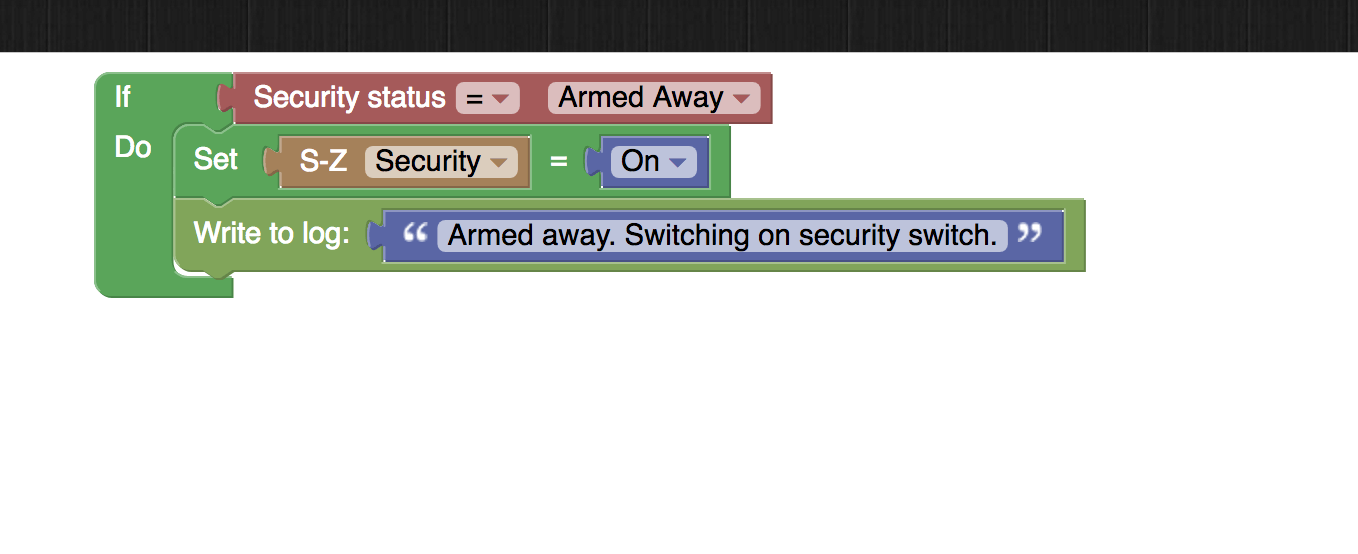

I've tried creating a blockly for my Security Panel (because it is really messy in LUA), but this still is not working :
Why is this not working...? I can in the logs even see an internal message that the Domoticz Security Panel status changed, but this blockly thing is not doing anything...

I had a similar problem: Blockly is not able to detect the change of the security state.
You can only check the state within another event. So you need to use LUA.
Maybe this thread helps you: viewtopic.php?p=139303#p139303
