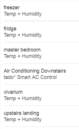

My sensors are shown as Temp and Humidity. As a matter of interest, what thermostat do you have in your living room?
temp sensors.jpg (27.03 KiB) Viewed 5924 times
qwerk
Posts: 222
Joined: Tuesday 22 July 2014 7:21
Re: Amazon Echo to Domoticz Bridge: switches, sensors & more
Post by qwerk »
as far as I know, amazon bridge can't handle "double" sensors at this moment.
In domoticz I split them into seperate sensors.
