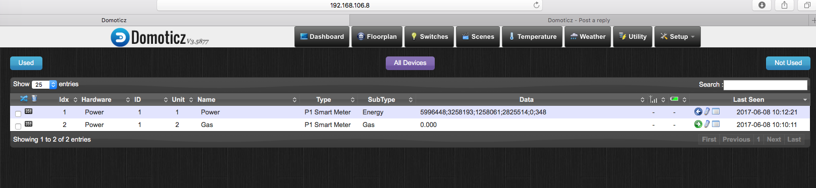

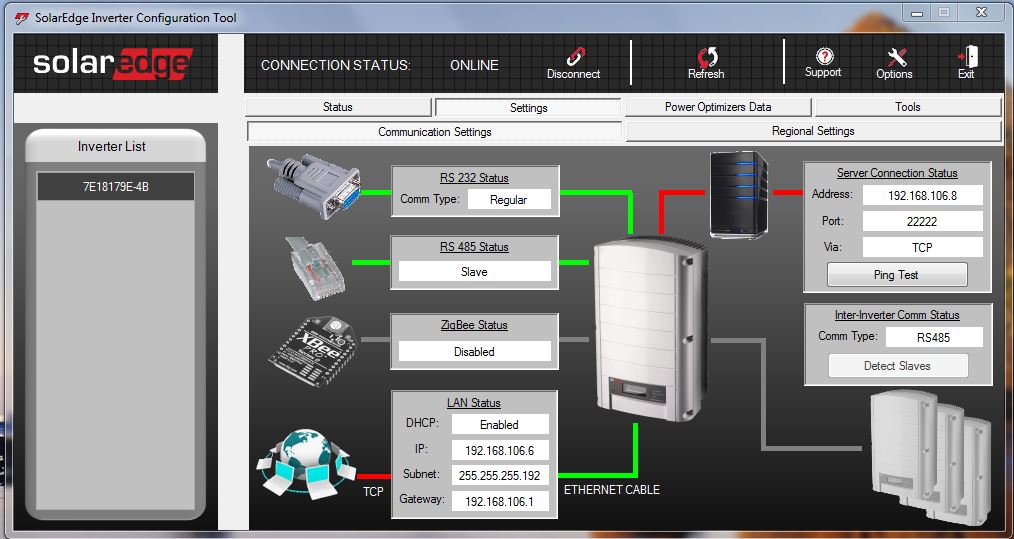

I think I've done everything according to the roadmap.
RPI 3B RASPBIAN JESSIE
Domoticz V3.587
See screenshots
Why does there not listening any thing on port 2222
Domoticz V3.587
See screenshots

SolarEdge via lan does not work for 6 Months. Use SolarEdge via Web API instead.

What kind of connection do I have to use to edit the SolarEdge inverter with the SolarEdge configuration tool version2?
Is it possible to connect over the LAN interface or is it only possible with a serial connector or USB? And what kind of cable do I have to get?

I have been searching on this subject for sometime. If you have a TCP and LAN cable connection on your SolarEdge inverter this document might be interesting.freijn wrote: Monday 02 October 2017 21:27 I have no Clue where to start....
Anybody can point us in the correct direction please?
A test with the Shortbus Modbus Scanner tool shows it is possible to read/scan the output of your SolarEdge via the local-ip port 502. This proofs that reading your SolarEdge via TCP configuration works. See pages 7/8 of the above mentioned document.
I hope this gives you a starting point

Here is another starting point for you.freijn wrote: Monday 02 October 2017 21:27 I have no Clue where to start....
Finally, I have a working solution to get data direct from my SolarEdge The Sunspec-Monitor Although it is a Perl script it works OK. Next step is to get it running every 5 minutes within Domoticz.
It reads the complete registers and this is the output
INVERTER:
Model: SolarEdge SE3500
Firmware version: 3.2173
Serial Number: 73xxxxxx
Status: SLEEPING
Power Output (AC): 0 W
Power Input (DC): 0 W
Efficiency: 0.00 %
Total Production: 165.755 kWh
Voltage (AC): 234.30 V (50.01 Hz)
Current (AC): 0.00 A
Voltage (DC): 0.50 V
Current (DC): 0.00 A
Temperature: 30.95 C (heatsink)
Greetings McMelloW
