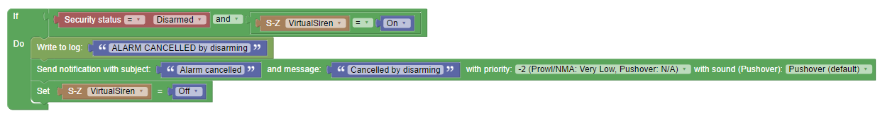

Event "CancelSiren" - Security (!!!) - Cancel False Alarm by disarming while siren is active:
Continued in next post...

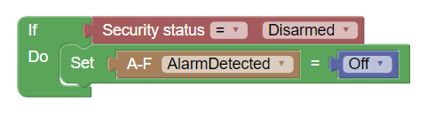

Finally, we can reset the "AlarmDetected" virtual device on disarming - not strictly required, but this way the "AlarmDetected" device can also be used as a useful indicator:
Event "SirenON" (top) / "SirenOFF" (bottom) - Security (!!!):
I hope this helps some of you! Feedback welcome. If someone wants to update the Wiki based on this, or use it in any other way, feel free to do so.
All the best,

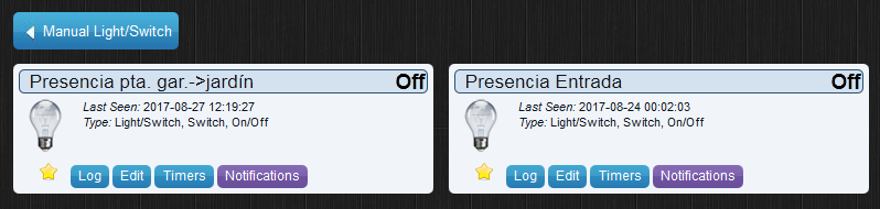

I have configured Notifications on the devices as shown in the attached pictures.
¿Is there any way to disable the sending of those notifications when the system is 'disarmed' via the Security Panel?
I was thinking about a lua or blockly script to check the status of the system, and only if it is not 'disarmed' allow Domoticz to send notifications for all devices, but I have not been able to find a way to globally disable the sending of notifications.
Thanks,
Fran
