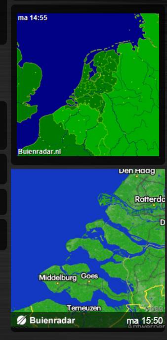

I have placed it in a 2 width column under the buienradar gif image as you can see...
Naamloos 1.jpg (31.14 KiB) Viewed 3172 times

HansieNL
Posts: 969
Re: Dashticz - Feature Requests
Post by HansieNL »
Derik wrote:mmm do i need more to install?
Last beta, from just in time.
Copy past your code.
set after the colum var frames.buienradar?
colum 2 3 and 4 no luck 2 All.
Some other settings??
Can you post your config.js? Then we can take a look where it goes wrong. Don't forget to remove your personal keys/links.

@Derik: you used columns[4]['blocks'] = ['blocktitle_2','frames.buienradar' ], can you remove the apostrophes so you get columns[4]['blocks'] = ['blocktitle_2',frames.buienradar] and try again.
