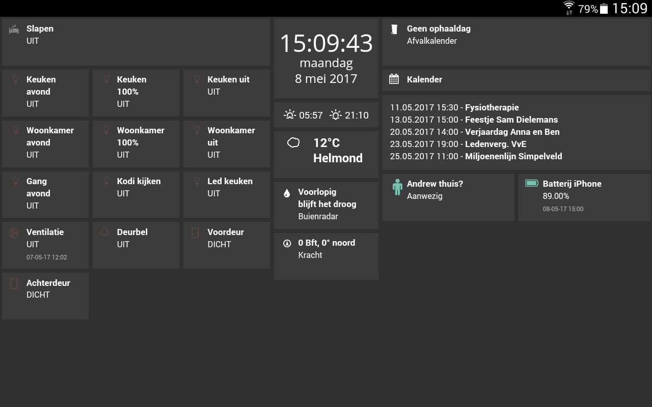

I have in the custom.js code that turns on/off into aanwezig/afwezig (see Andrew thuis?). Is it right that last seen then don't work? When i quote it out then last seen is working. Is it possible to get it anyway with custum.js.
- Screenshot_2017-05-08-15-09-45.jpg (72.63 KiB) Viewed 3679 times

Hi I useSwordFish wrote:I have in the custom.js code that turns on/off into aanwezig/afwezig (see Andrew thuis?). Is it right that last seen then don't work? When i quote it out then last seen is working. Is it possible to get it anyway with custum.js.
blocks[idx]['hide_data'] = true;-

But I wanne see last seen

SwordFish wrote:But I wanne see last seen
in config.js you put for all
VAR _SHOW_LASTUPDATE = true or false
and per block
blocks[xx] = {}
blocks[xx]['show_lastupdate'] = true or false

If I useSwordFish wrote:But I wanne see last seen
var _SHOW_LASTUPDATE = true;Code: Select all
blocks[73] = {}
blocks[73]['width'] = 6;
blocks[73]['icon'] = 'fa-home';
blocks[73]['hide_data'] = true;
blocks[73]['title'] = 'Paul';
