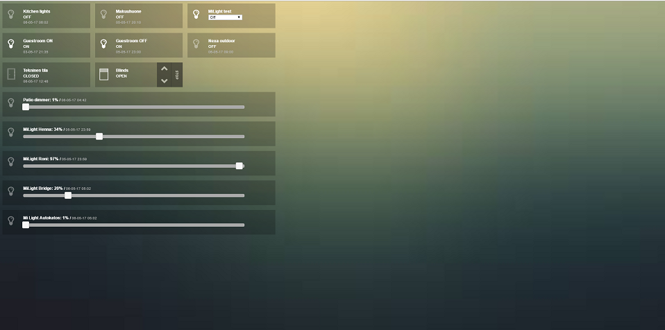

Hi, my config.js was lowercase, not uppercase, so i got something back, but buttons are still missing... Im using fresh CONFIG.js, only host and such edited.

Here is all i see now, with above CONFIG.js
And endlessly in chrome console :
Uncaught TypeError: disableStandby is not a function
    at HTMLBodyElement.<anonymous> (main.js:413)
    at HTMLBodyElement.dispatch (jquery.min.js:3)
    at HTMLBodyElement.r.handle (jquery.min.js:3)

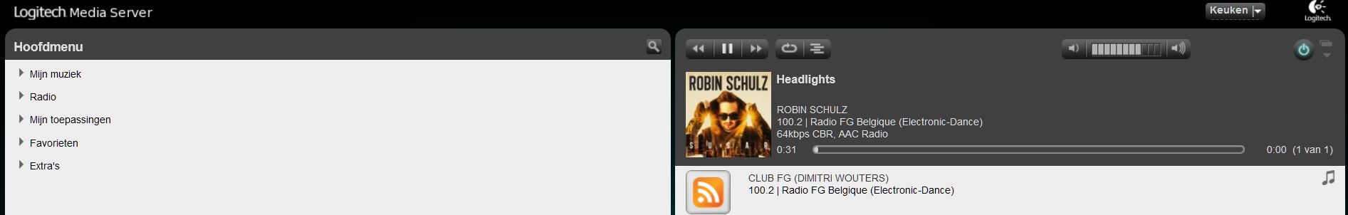

A have a question about the music controls. Is it possible to make the buttons larger for play , pause, etc... ? A have my Logitech media server on my synology nas and when a use squeezeplay on my phone , tablet ,a see a cover from what is playing with some radiostations. A think that these come from http://www.tunein.com . These covers see a also on my LMS , so they must keep them from some source.
Should it be possible to see these also on my dashboard screen ? A have searching for this a lot , but a found nothing how to do that. Maybe are here some users who are more capable for how to do this. Also thanks in advance.
Here some screenshot from my LMS where you see the whats playing cover.
Sorry , wrong subforum. A copied to Dashticz - Feature Requests :oops: http://www.domoticz.com/forum/viewtopic ... 67&t=17424
radio cover.JPG (50.88 KiB) Viewed 3087 times
Error:
About the error, I can confirm that when you have var _STANDBY_AFTER_MINUTES = false; then you get this error. Something is wrong in the main.js file. I wil notice @robgeerts for this.
Put the var _STANDBY_AFTER_MINUTES = 10; than the error is gone for the moment.
Question:
You say "--------------Everything below this are uncommented --------" . Do you mean you removed the // for the lines?
var _LANGUAGE                           = 'en_US'; //or: en_US, fr_FR, hu_HU
var _HOST_DOMOTICZ                      = 'http://192.168.xxx.xxx:8080';
var _DOMOTICZ_REFRESH           = 5; //in seconds
var _DASHTICZ_REFRESH           = 30; //in minutes
var _HOST_ZIGGO_HORIZON         = ''; //e.g. http://192.168.1.3/domoticz/switch_horizon.php';
var _APIKEY_WUNDERGROUND        = '';
var _WEATHER_CITY                       = 'Eindhoven';
var _WEATHER_CITYNAME           = ''; //show a different city name, leave empty if same as _WEATHER_CITY
var _WEATHER_COUNTRY            = 'NL';
var _USE_AUTO_POSITIONING       = true; //don't want to configure positions, use auto positioning
var _USE_FAVORITES                      = true; //only used when using auto positioning
var _HIDE_SECONDS_IN_CLOCK  = false; //do not show the seconds in the clock
var _NEWS_RSSFEED                       = 'http://www.nu.nl/rss/algemeen';
var _USE_FAHRENHEIT                     = false;
var _USE_BEAUFORT                       = true; //Bft instead of m/s
var _TRANSLATE_SPEED            = false; //windspeed, north northwest instead of NNW
var _STANDBY_AFTER_MINUTES  = false; //enter amount of minutes like: 5 (5 minutes)
var _SCROLL_NEWS_AFTER          = 7000; //milliseconds, so 7000 is 7 seconds
var _SHOW_LASTUPDATE            = true;
var _LASTUPDATE_FORMAT          = 'DD-MM-YY HH:mm';
var _SCREENSLIDER_EFFECT        = 'slide'; //'slide' or 'fade' or 'cube' or 'coverflow' or 'flip'
var _APIKEY_MAPS                        = '';
var _MAPS_LATITUDE                      = '';
var _MAPS_LONGITUDE                     = '';
var _AUTO_SWIPEBACK_TO          = 1; //when no activity, swipe back to main screen after x seconds
var _AUTO_SWIPEBACK_TIME        = 10; //seconds
// Online Radio Stream Plugin, Note: you must enable  plugin in column section 'streamplayer', see columns[3]['blocks'] example below.
var _STREAMPLAYER_TRACKS        = [
                                                                {"track":1,"name":"Music FM","file":"http://stream.musicfm.hu:8000/musicfm.mp3"},
                                                                {"track":2,"name":"Radio 1","file":"http://213.181.210.106:8000/high.mp3"},
                                                                {"track":3,"name":"Test FM","file":"http://213.181.210.106:8000/high.mp3"},
// iCalendar Plugin, supports all .ics calendar types like Google Calendar, Apple Calendar
var _ICALENDAR_URL                      = 'https://testurl.com/ical.ics'; //supports .ics type calendars (Google Calendar, Apple Calendar etc.)
var _ICALENDAR_DATEFORMAT       = 'friendly'; //'friendly', 'MM.DD.YYYY HH:mm', 'DD.MM.YYYY HH:mm', 'YYYY.MM.DD HH:mm'
var _ICALENDAR_LOCALE           = 'en'; //en,hu, etc.
//Buttons or images to open webpages in an iframe, like a news website or weather forecast
var buttons = {}
buttons.buienradar = {width:12, isimage:true, refreshimage:60000, image: 'http://api.buienradar.nl/image/1.0/RadarMapNL?w=285&h=256', url: 'http://www.weeronline.nl/Europa/Nederland/Son/4058667'}
Error:
Question:
Or did you mean to write 'everything are commented' ??
They all have // before them, just like they had in default. Sry for my english :) I meant they are "commented out" if thats how you should say it :D
