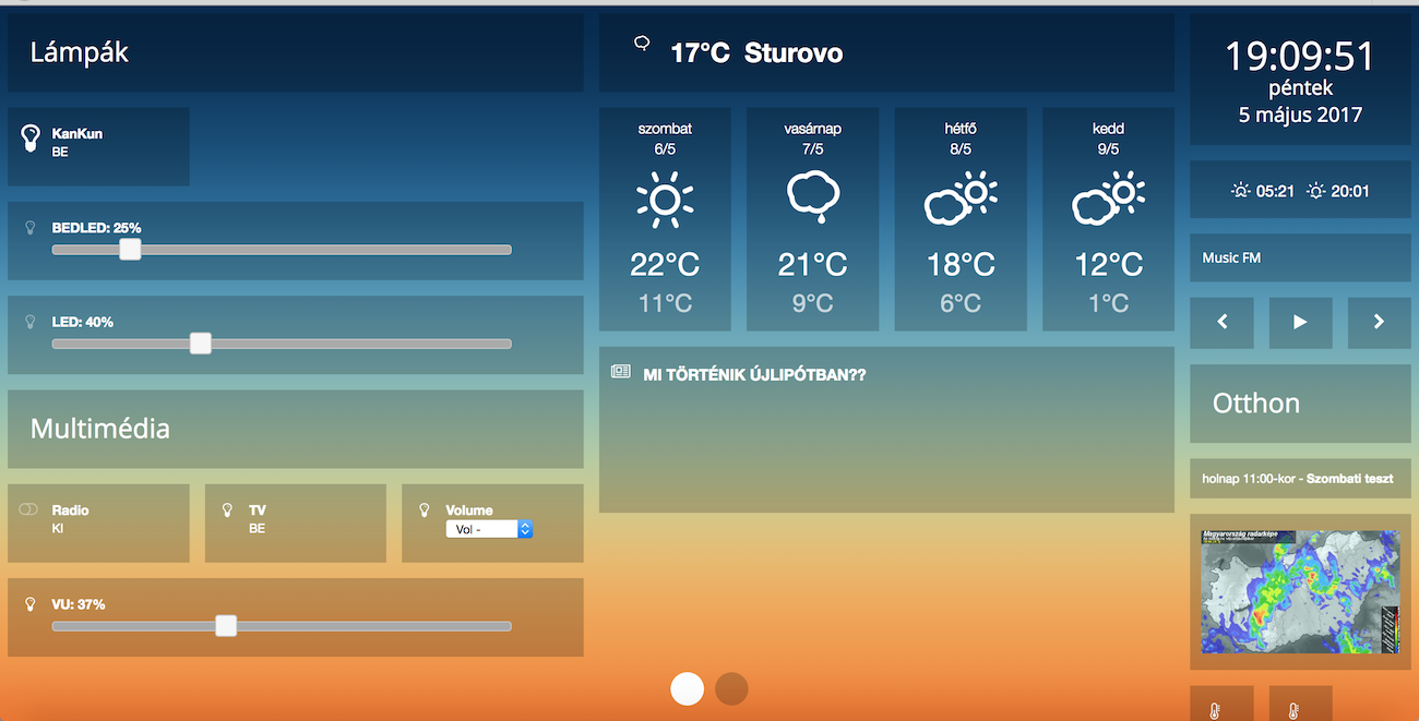

iCloud style background:

var _APIKEY_MAPS         = ';
var _MAPS_LATITUDE         = 51.850978;
var _MAPS_LONGITUDE      = 4.321489;
var _MAPS_ZOOMLEVEL = 11
var _SCREENSLIDER_EFFECT        = 'slide'; //'slide' or 'fade' or 'cube' or 'coverflow' or 'flip'
Am I missing something ?
Do you have this in your code?
var columns_standby = {}
columns_standby[1] = {}
columns_standby[1]['blocks'] = ['clock','currentweather_big','weather']
DvD
Posts: 18
Joined: Wednesday 22 January 2014 13:29
Post by DvD »
nope... I don't use the "var columns standby" because I only want the screen to dimm
