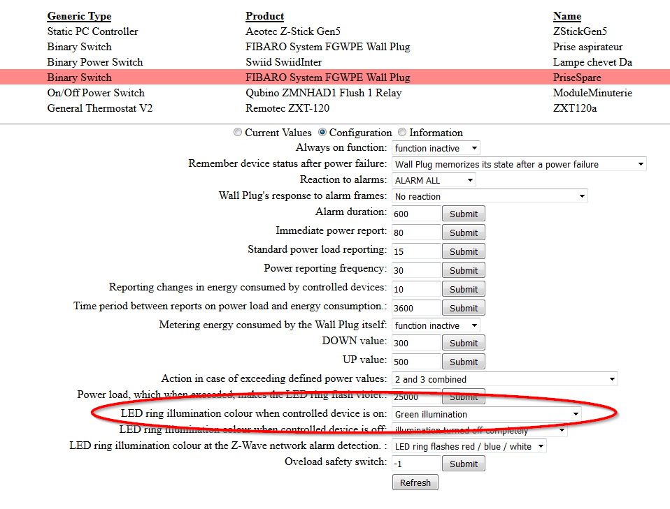

Is it possible to send a Z-Wave command to a device in LUA?
For instance, I would like to change the ring color of a Fibaro wall plug (FGWPE). Using the OpenZWave control panel (as shown in the picture below) I can do this, but using a LUA script, is it possible also?

Don't know about lua, but possible in PHP:
<?php
$domoticzurl='http://127.0.0.1:8080/';
$zwaveidx=7;
file_get_contents($domoticzurl.'json.htm?type=openzwavenodes&idx='.$zwaveidx);
function ValuePost($command) {
	global $domoticzurl;
	$zwaveurl=$domoticzurl.'ozwcp/valuepost.html';
	$zwaveoptions = array('http'=>array('header'=>'Content-Type: application/x-www-form-urlencoded\r\n','method'=>'POST','content'=>$command,),);
	$zwavecontext=stream_context_create($zwaveoptions);
	$result=file_get_contents($zwaveurl,false,$zwavecontext);
	return $result;
echo ValuePost('85-CONFIGURATION-config-list-1-62=Green illumination');
What to post can be looked up in developer view of your browser. The example above sets the illumination to green of node 85.

curl --data "85-CONFIGURATION-config-list-1-62=Green illumination" http://127.0.0.1:8080/ozwcp/valuepost.html
valuepost.html does not exist as webpage, it's a page "inside http Domoticz server"

I was wondering. When invoking the script with nodeID, Function and Value, how does one know the id of the function and the possible values. In the examples the function '62' is called. What is function 62 and what are the other functions?

I have the same question. How did you come up with the "85-CONFIGURATION-config-list-1-62=Green illumination" string? Thanks.
