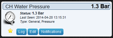

Waterpressure is reported in PS:1 reports:
00:39:57.617781 00000000/00000000,10.00,00000000/00000000,100.00,0/0,15.00,0.00,1.30,19.76,51.20,48.30,10.90,41.70,0/0,0/0,0.00,70.00,8869,0,0,59136,14684,0,0,0
Could you add this water pressure value to Domoticz as a sensor?
gizmocuz
Posts: 2709
Location: Top of the world
Re: [120] opentherm gateway
Post by gizmocuz »
DatafoxChris wrote:Waterpressure is reported in PS:1 reports:
Lucky you... i do not receive this value (always zero on my Remeha)
I added a new Pressure sensor (Bar) in version #1676, hope all is working well... (beta will be uploaded within an hour)
Pressure Sensor
Pressure Sensor
/Rob
DatafoxChris
Posts: 10
Joined: Thursday 13 March 2014 23:09
Post by DatafoxChris »
Yes it works perfectly, you rock !
THANKS
