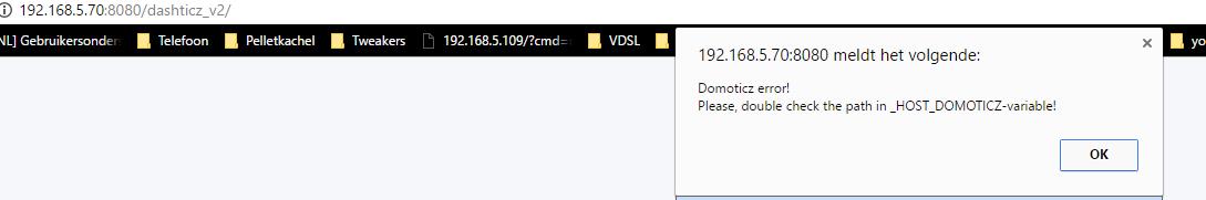

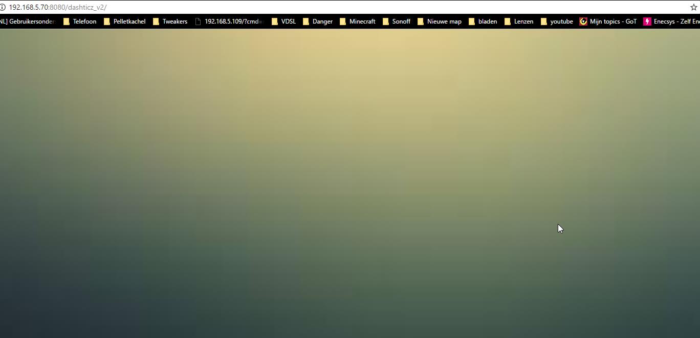

Derik
Posts: 1605
Re: Dashticz v2.0, custom positioning and multiple screens
Post by Derik »
grrr
V2.o from github with gitclone. [ from the wiki ]
I do have:
a CONFIG.js
var _LANGUAGE 			= 'nl_NL'; //or: en_US, fr_FR, hu_HU
var _HOST_DOMOTICZ		  	= 'http://192.168.5.70:8080';
var _DOMOTICZ_REFRESH		= 5; //in seconds
var _DASHTICZ_REFRESH		= 10; //in minutes
var _HOST_ZIGGO_HORIZON	  	= ''; //e.g. http://192.168.1.3/domoticz/switch_horizon.php';
var _APIKEY_WUNDERGROUND  	= '';
var _WEATHER_CITY 			= 'Nijmegen';
var _WEATHER_CITYNAME 		= ''; //show a different city name, leave empty if same as _WEATHER_CITY
var _WEATHER_COUNTRY 		= 'NL';
var _USE_AUTO_POSITIONING 		= true; //don't want to configure positions, use auto positioning
var _USE_FAVORITES			= true; //only used when using auto positioning
var _HIDE_SECONDS_IN_CLOCK 		= false; //do not show the seconds in the clock
var _HIDE_MEDIAPLAYER_WHEN_OFF 	= false; //when you have a mediaplayer connected, hide it if nothing is playing
var _NEWS_RSSFEED			= 'http://www.nu.nl/rss/algemeen';
var _USE_FAHRENHEIT			= false;
var _USE_BEAUFORT 			= true; //Bft instead of m/s
var _TRANSLATE_SPEED 		= false; //windspeed, north northwest instead of NNW
var _STANDBY_AFTER_MINUTES  		= false; //enter amount of minutes like: 5 (5 minutes)
var _SCROLL_NEWS_AFTER 		= 7000; //milliseconds, so 7000 is 7 seconds
var _SHOW_LASTUPDATE 		= true;
var _LASTUPDATE_FORMAT 		= 'DD-MM-YY HH:mm';
var _SCREENSLIDER_EFFECT 		= 'slide'; //'slide' or 'fade' or 'cube' or 'coverflow' or 'flip'
var _APIKEY_MAPS			= '';
var _MAPS_LATITUDE			= '';
var _MAPS_LONGITUDE			= '';
var _AUTO_SWIPEBACK_TO		= 1; //when no activity, swipe back to main screen after x seconds
var _AUTO_SWIPEBACK_TIME		= 10; //seconds
// Online Radio Stream Plugin, Note: you must enable  plugin in column section 'streamplayer', see columns[3]['blocks'] example below.
var _STREAMPLAYER_TRACKS  	= [
								{"track":1,"name":"Music FM","file":"http://stream.musicfm.hu:8000/musicfm.mp3"},
								{"track":2,"name":"Radio 1","file":"http://213.181.210.106:8000/high.mp3"},
								{"track":3,"name":"Test FM","file":"http://213.181.210.106:8000/high.mp3"},
// iCalendar Plugin, supports all .ics calendar types like Google Calendar, Apple Calendar
var _ICALENDAR_URL			= 'https://testurl.com/ical.ics'; //supports .ics type calendars (Google Calendar, Apple Calendar etc.)
var _ICALENDAR_DATEFORMAT		= 'friendly'; //'friendly', 'MM.DD.YYYY HH:mm', 'DD.MM.YYYY HH:mm', 'YYYY.MM.DD HH:mm'
var _ICALENDAR_LOCALE		= 'en'; //en,hu, etc.
//Buttons or images to open webpages in an iframe, like a news website or weather forecast
var buttons = {}
buttons.buienradar = {width:12, isimage:true, refreshimage:60000, image: 'http://api.buienradar.nl/image/1.0/RadarMapNL?w=285&h=256', url: 'http://www.weeronline.nl/Europa/Nederland/Son/4058667'}
//CUSTOM POSITIONING:
//defining wich blocks to show, de numbers represents the IDX of the device in Domoticz
//only define if you want to use a custom width instead of the default
var blocks = {}
blocks[1] = {}
blocks[1]['width'] = 4;
blocks[1]['title'] = 'Living room'
blocks[1]['icon'] = 'fa-eye';
blocks[1]['image'] = 'bulb_off.png';
blocks[204] = {5} //dimmer
blocks[204]['width'] = 12;
blocks[204]['title'] = 'Living room' //if you want change the name of switch different then domoticz
blocks['blocktitle_1'] = {test'}
blocks['blocktitle_1']['title'] = 'Schakelaars';
var columns = {}
columns[1] = {}
columns[1]['blocks'] = ['Tester_1',9,2,62,'144_2',204,248,295] //remark: idx 144 produces 2 blocks, so you can use: '144_1' and '144_2' (or of course, just 144 if you want one)
columns[1]['width'] = 5;
columns[2] = {}
columns[2]['blocks'] = ['currentweather_big','weather',5,'144_1']
columns[2]['width'] = 5;
columns[3] = {}
columns[3]['blocks'] = ['clock','sunrise','horizon','streamplayer',buttons.buienradar,buttons.radio,buttons.calendar,buttons.nunl,buttons.nzbget]
columns[3]['width'] = 2;
//var columns_standby = {}
//columns_standby[1] = {}
//columns_standby[1]['blocks'] = ['clock','currentweather_big','weather']
//columns_standby[1]['width'] = 12;
//if you want to use multiple screens, use the code below:
var screens = {}
screens[1] = {}
screens[1]['background'] = 'bg1.jpg';
screens[1]['background_morning'] = 'bg_morning.jpg';
screens[1]['background_noon'] = 'bg_noon.jpg';
screens[1]['background_afternoon'] = 'bg_afternoon.jpg';
screens[1]['background_night'] = 'bg_night.jpg';
//screens[2] = {}
//screens[2]['background'] = 'bg3.jpg';
//screens[2]['background_morning'] = 'bg_morning.jpg';
//screens[2]['background_noon'] = 'bg_noon.jpg';
//screens[2]['background_afternoon'] = 'bg_afternoon.jpg';
//screens[2]['background_night'] = 'bg_night.jpg';
//screens[2]['columns'] = [4,5,6]
Without any Api because need to learn..
I do have:
Only no custom page with columns or blocks
So please where do i go wrong looks not so difficult....
Just the blank page is not what i was expecting... :roll: :roll:
Edit:
See now a error:
Check the domoticz adres and this is ok...
I do have:
Edit:
See now a error:
I had the same issue today, after doing a git pull.
Seems that something went wrong, because I had the same issue. Looking into the problem, it seems that I didn't had an empty image (img) directory.
Copied my custom directory, renamed the dashboard folder to .org and did a new git clone.
Still no images and the same issue. After uploading the images from a backup, everything is Ok.
@Robgeerts, is there a possible issue with the github configuration?

Derik wrote:grrr
Edit:
See now a error:
I noticed that you als get that error when there is something else wrong. When i make a typo in a part of a 'var' then it also gives that error.

I do have:
Edit:
See now a error:
I just pulled it from gitlab, renamed config-default.js to config.js. Then I only changed the domoticz path and worked like a charm....
