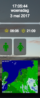

SuperMouse wrote:
bsmeding wrote:
bsmeding wrote: That would be great, then it would also be possible to only show the status of a switch without name or time last changed?
Because i would like to use a 1-column row with the status of devices on- or offline in the network and also a 1-column for the status of door- and window state. Therefor the text and padding needs to be smaller.
Will try this in beta, thanks for this very nice dashboard!
Just tested this code in beta and it does exactly what i need! Thanks Rob!
Hi B.
I have the icons and 'aanwezig' running now, thanks for that !
But how to get the lastudate working?
Do I need to add this in blocks ? like:
blocks[121] = {}
blocks[121]['lastupdate'] = true
How did you do this?
Hi SuperMouse,
The last status is a thing I just removed from the block with
// Gebruikers
blocks[402] = {}
blocks[402]['icon'] = 'fa-male';
blocks[402]['title'] = 'B';
blocks[402]['hide_lastupdate'] = true;
blocks[402]['switch'] = false;
Only in the screenshots earlier posted the date time was shown like it normal does by every switch, nothing special. Only i don't want / need the last update now, only the icons
Bart

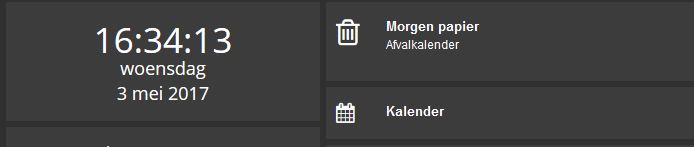

robgeerts wrote:Link on multiple calendars
In latest beta it is possible to add a click-function to the calendar-block.
var calendars = {}
calendars.wedevise = { icalurl: 'http://urlto.com/basic.ics' }
calendars.private = { icalurl: 'http://urlto.com/basic.ics' }
calendars.combined = {}
calendars.combined.calendars = [
	{ color:'white',calendar:calendars.wedevise },
	{ color:'#ccc',calendar:calendars.private }
calendars.combined.url = 'https://linktocalendar.com';
WARNING: if you already used combined calendars, change it to the code above, with or without the url part ('calendars' in varname has been added)
Not really sure how to use this:
I have three calendars, OK I can only use 2, so I use the 2 URL's for the 2 calendars I want to add in the 2 first URL's I can add.
But then the calendars.combined : what URL can I use in the calendars.combined.url in the case of an iCloud calendar? Just https://www.icloud.com/#calendar ?
Also, nothing shows up. I'm using:
var calendars = {}
calendars.wedevise = { icalurl: 'https://cors-anywhere.herokuapp.com/https://p9-calendars.icloud.com/published/2/nuh36ehiyk-cut-KHmFSf4cTYEptui-tRa1buriW7k' }
calendars.private = { icalurl: 'https://cors-anywhere.herokuapp.com/https://p3-calendarws.icloud.com/ca/subscribe/1/bknN4a2idziGc9c-ao-cut-m6Yof9Q' }
calendars.combined.url = 'https://www.icloud.com/#calendar';
and:
columns[3] = {}
columns[3]['blocks'] = ['clock',calendars.combined]
columns[3]['width'] = 2;
