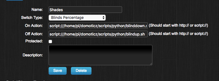

Ok, this is how far I got, created a dummy switch blind control that links to two bash scripts to pull the blind up and down.
This part works ok.
The slider, how can I connect the % number of the slider to an external script? or bash script?
The way the python script works is something like this: 'python script.py -a 72' , 72 being the percentage height I want to set up the blinds at.
Any ideas?

Right, finally got it working! It is not clean as I have no idea about LUA or similar and I'm making it as I go along...
1st I create a LUA script that triggers on event only (not idea how to do it directly inside the file system yet):
local val_shades = otherdevices_svalues['Shades']
if val_shades ~= nil then
    cmd = "/usr/bin/python  /home/pi/domoticz/scripts/python/control.py  -t [your BT mac without the brackets] -c move_target -a "..val_shades
    os.execute(cmd)
return commandArray
Then on the virtual dummy switch I add the following for OFF:
http://YourDomoticzIP:Port/json.htm?type=command&param=udevice&idx=deviceID&svalue=100
and similar for ON:
http://YourDomoticzIP:Port/json.htm?type=command&param=udevice&idx=deviceID&svalue=0
or viceversa...
Now this creates an infinite loop that keep sending commands as my LUA script is triggering continuously... no idea how to fix that yet. But since it is a more common thing, maybe someone more experience with LUA and dummy devices can help me making it a bit more stable? ;)
I thought about updating a user variable to check before triggering but didn't manage to write to the variable inside Domoticz. Any lights would be welcome :D
The sliders and everything works.
This part works ok.
Hi EddieN
I got my smart shades. Good part is, I got it (the scripts) working in Terminal, (SSH).
Bad part is I didn't get it working in the switch on/off script, as suggested in your image...
Do you have any ideas?

The ON / OFF is a bit of a hit an miss. Basically the slider works with the code above.
The OFF (or the ON, cannot remember now) works ok but the other one sends the system repeated commands. The way I did it it is to call the API directly from the virtual switch for ON and OFF
and OFF
Keep an eye on the logs (make sure to put debug info) and you'll see what I mean. I'm sure there's a more elegant way to do this... with a bit of patience. viewtopic.php?f=17&t=16952#p132085

Ok, I just had a look at it. This is what I have:
The control.py file inside the scripts folders for domoticz. then I have a LUA script like this:
local status_shades = otherdevices['Shades']
print ("S value " ..val_shades)
print ("status " ..status_shades)
    if status_shades ~= nil then
        print ("Trigger value " ..val_shades)
        cmd = "/usr/bin/python  /home/pi/domoticz/scripts/python/control.py  -t ED:3D:C0:F7:07:FB -c move_target -a "..val_shades
        os.execute(cmd)
return commandArray
Notice that the "ED:3D:C0:F7:07:FB" is the bluetooth mac of the soma shades. Make sure the LUA under envents is set to trigger with device only. with the above you should be able to use the slider. I called my virtual device "Shades".
for the ON and OFF: on ON action I edite the virtual device to call this API:
http://DomoticzIP:Port/json.htm?type=command&param=udevice&idx=IDX&nvalue=0&svalue=100
or svalue=0 depending if inverted.
Hope this help. Otherwise paste some code here and I'll try my best.
