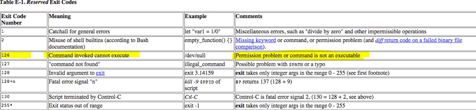

@shoyboom
and I think that your .sh file need to be set as executable.
this is what I have found about error 126

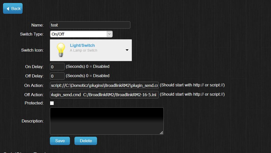

shoyboom
Posts: 12
Joined: Saturday 25 March 2017 16:42
Re: RE: Re: Python Plugin: Broadlink RM2 V2
Post by shoyboom »
zak45 wrote:@shoyboom
Gave it executable, got another error
Sent from my ONEPLUS A3000 using Tapatalk

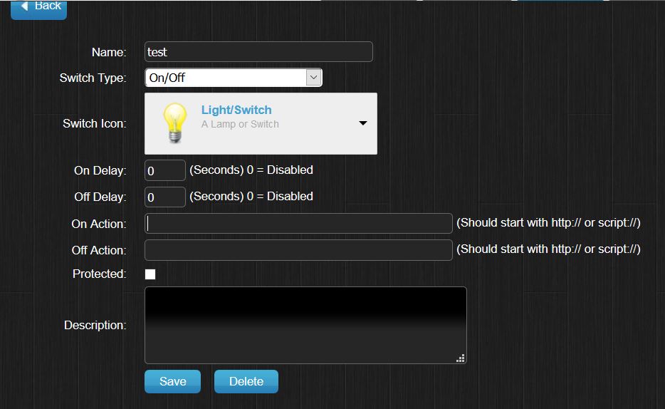

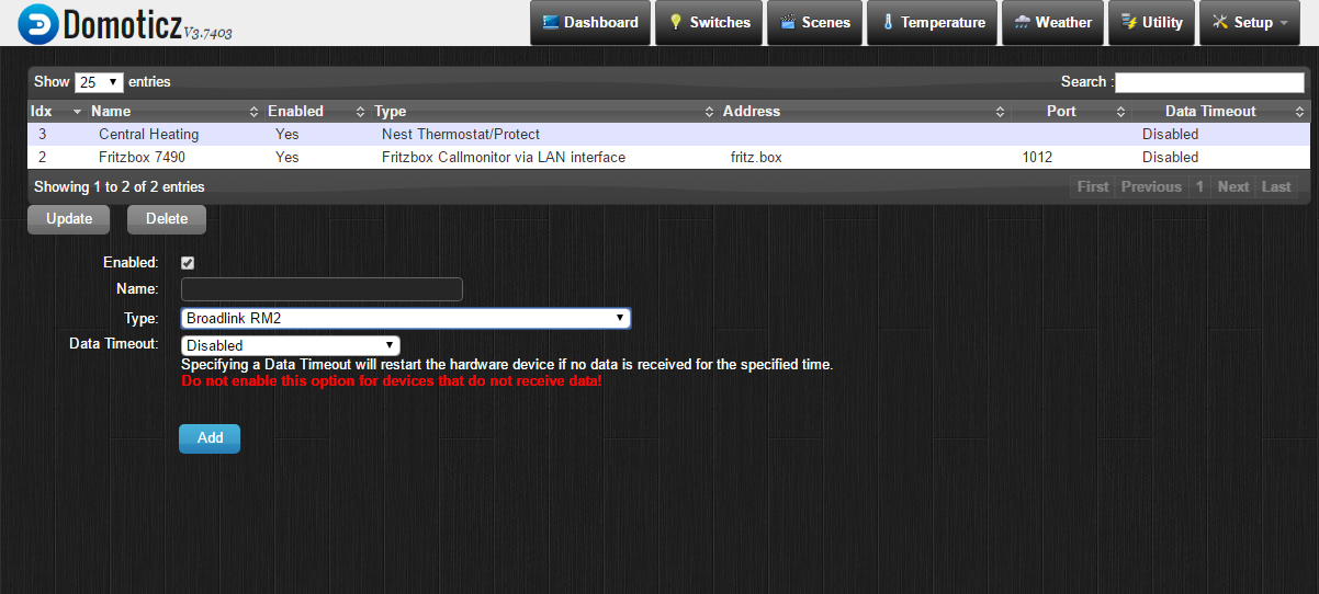

Yes to the BroadlinkRM2 folder, I've read the articles about chnmodding the py scripts too, done all that. I assume it's reading that, as I see Broadlink RM2 in the hardware - but I don't get the full set of parameters.
Where would I see this? I've looked at dmesg - there's absolutely nothing in my Domoticz log. When I restart the service from the command line I don't get anything like this...
This is all I get :(
domoticz problem.png (119.29 KiB) Viewed 3803 times

flyguy729
Joined: Monday 01 May 2017 11:08
Post by flyguy729 »
DrJS wrote:
zak45 wrote:@DrJS
and do you have created the BroadlinkRM2 folder under plugins and stored on it plugin.py ?
and when you restart Domoticz, do yhou have confirmation that all is ok regarding python plugin system:
2017-04-29 22:45:12.011 Domoticz V3.7310 (c)2012-2017 GizMoCuz
2017-04-29 22:45:12.011 Build Hash: c2017701, Date: 2017-04-12 11:42:19
2017-04-29 22:45:12.052 Sunrise: 06:36:00 SunSet:20:58:00
2017-04-29 22:45:12.052 EventSystem: reset all events...
2017-04-29 22:45:12.089 PluginSystem: Started, Python version '3.5.3'.
2017-04-29 22:45:12.096 Active notification Subsystems: email, kodi, pushbullet (3/12)
2017-04-29 22:45:12.098 WebServer(HTTP) started on address: :: with port 8080
2017-04-29 22:45:12.232 WebServer(SSL) started on address: :: with port 443
you need to have PluginSystem: Started etc ...
I'm having the same problem as well. Anyone can enlighten us on why we're not getting the configuration field?
Running on beta version. Even xiaomi gateway doesn't have the configuration column.
What could be the problem?
zak45
Posts: 954
Domoticz version: V2024.4
Post by zak45 »
jlites00 wrote:Don't know if this a plugin or domoticz question. For my TC2 switches, it creates two set of codes ON & OFF. How do I include that as one toggle?
Mening not having two separate switches for ON / OFF.
The other thing to know about the TC2 configuration, the plugin dosen't do the multification of HEX code for you. One will need to re-edit the ini file to see what work best.
If it't not too much to ask. It will be nice to be able to do the multification in Domoticz without manually multiplying the HEX in the "ini" file.
Just create a dummy switch and put on the on & off action necessary command. if you keep existing devices, you can use http / json to do that and if you decide to remove devices you can use script/command line to do the same.
for TC2, it looks like it's work.. nice.

Once you have created your Dummy switch put on it your scripts:
what you see is for Windows, need to be adapted to your OS... but all if this work.
