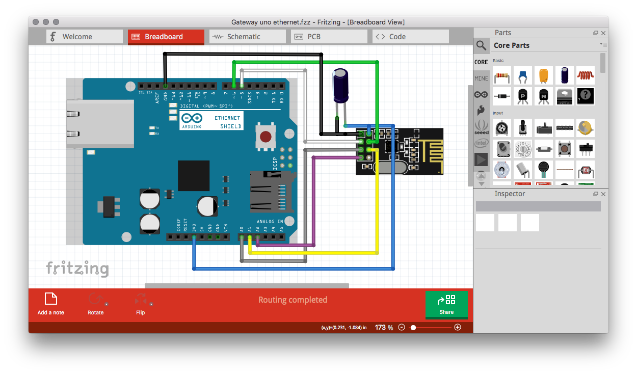

trixwood
Re: MySensors - only ethernet nodes
The radio is wired differently,
Did you do that? I forgot the first time cuz I have a shield... and wired it as normal serial... that does not work.
