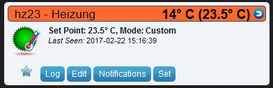

Setpoint device is working now, thanks!
But the other one (type 70 - Heating / Zone) have same issue, sorry.
I can update the device setting a new sValue, but it will not make any call if user will change the setpoint.
This device will be used to show the current temperature and setpoint + the current mode (custom, auto, permanent overwrite)
You can try same script as before.
Thanks again!
Michael

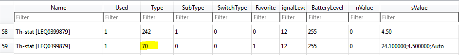

Hmm....
Maybe my fault.... with this id.
Creating it with "json.htm?type=createevohomesensor&idx="+hwidx+"&sensortype=70"
in database looks like:
Thermostat - ID
Thermostat - ID
Any idea?

Dnpwwo wrote:maybe you should try one of those.
Have rechecked the suggested device IDs - does not help:
Here are only switches present.
Only the "needed" device "70" have the "Set" option (Set setpoint)
This is the one working device - see above, you made it working.
Type 70 is defined here:
https://github.com/domoticz/domoticz/bl ... pes.h#L252 - if this help...
