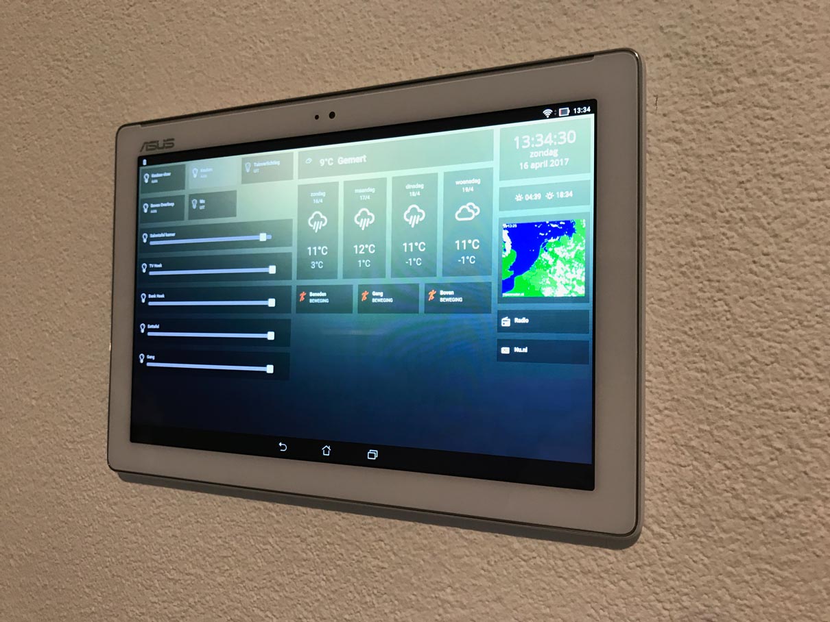

Thanks for this superb dashboard. I'm already playing and customizing it for 2 weeks now and it's working great. I hope the + / - function on setpoint will be updated in your new update of today?
Herewith a screenshot:

Nice tablet. Looks great on the wall. Dwarfs my 7" tablet.

Thanks, I just bought the new ASUS Zenpad 10, received it, opened the box, took of the backplate, drilled 3 holes and mounted the backplate on the wall and close the cover ;). I'm now busy with continuous power inside the wall so I have no wires in sight.
