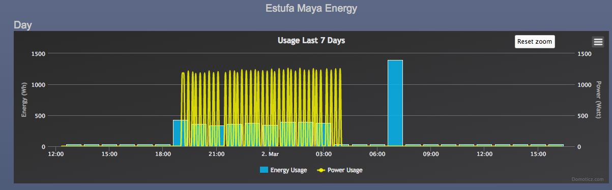

I have been using Domoticz with Z-wave for a while, even had a number of setups done from scratch, but the following issues seems to repeat over and over:
1.- For some reason, regardles of the hardware used, from very randomly the Energy reading jumps but not the power. See attached, any one experienced this? I'm using a mix of Aeon, Fibaro and TKB
Screen Shot 2017-03-07 at 14.43.13.png (149.33 KiB) Viewed 1360 times

That is not my experience. I have 2 fibaro Eyes and they have been working for months now perfectly for motion detection.
Only the lux sometimes seem to lag.
The yellow line in your screenshot shows the instant power-consumption at a particular moment. It looks like this is a lamp that has been switched on and off?

He chart. Is not the yellow line but the massive blue energy one.
