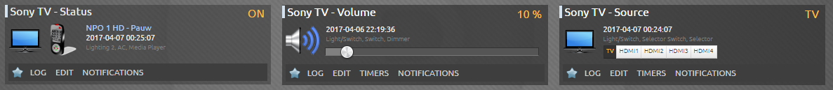

Re: Python plugin: Sony Bravia [ready for test]
Post by G3rard »
The plugin is ready for testing.
You can download the files from https://github.com/gerard33/sony-bravia.
The instruction is also on the Github page.
Let me know if the plugin is working for you.
If you have any issues or feature requests then please raise an issue on Github.
Not using Domoticz anymore
Anrox
Joined: Thursday 30 March 2017 16:59
Domoticz version: 3.7206
Location: Hungary
Post by Anrox »
I does work for me. No problems so far.
