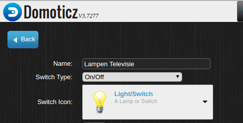

My problem, better said challenge is this:
When it is light enough in various rooms (this is determined by the variables w,g and o) i want the system to turn off the lights again.
This work perfectly for the lights in my living room (w). I think because this is a dimmer, but switch mode is set to "On/Off".

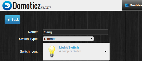

However it doesn't work for the light in my hallway (g and o), probably because these two are set to switch type "Dimmer".
Through some debugging i found out that my problem is the if statement below, it doesn't match:
if otherdevices['Gang']=='On' then
Strange enough it does match when specified as "Off".. Could this be because if the light is dimmed the correct value is not "On"?

Dimmer, but switch type set to &quot;On/Off&quot;
Dimmer, but switch type set to "On/Off"

Dimmer, and switch type set to &quot;Dimmer&quot;
Dimmer, and switch type set to "Dimmer"

the problem is caused by sometimes clicking on the lamp icon and sometimes sliding the dimmer balk.
When clicked on the icon the status goes to "On or Off"
When sliding the slider the status goes to "Set Level: 15 %"
I added the following code to tackle both ways..
sg=tonumber(string.match(otherdevices['Gang'],"%d+")) --> Sla percentage van dimmer op in variabele 'sg'
if g > 10 then --> Als de lichtsterkte in de gang meer dan 10 Lux is...
    if sg==nil then --> als de variabele sg leeg is..
            commandArray['Gang']='Set Level 0'
    else --> anders...
        if sg > 1 then --> En als de lamp in de gang nog aan is...
        commandArray['Gang']='Set Level 0' --> Doe ik die uit.
