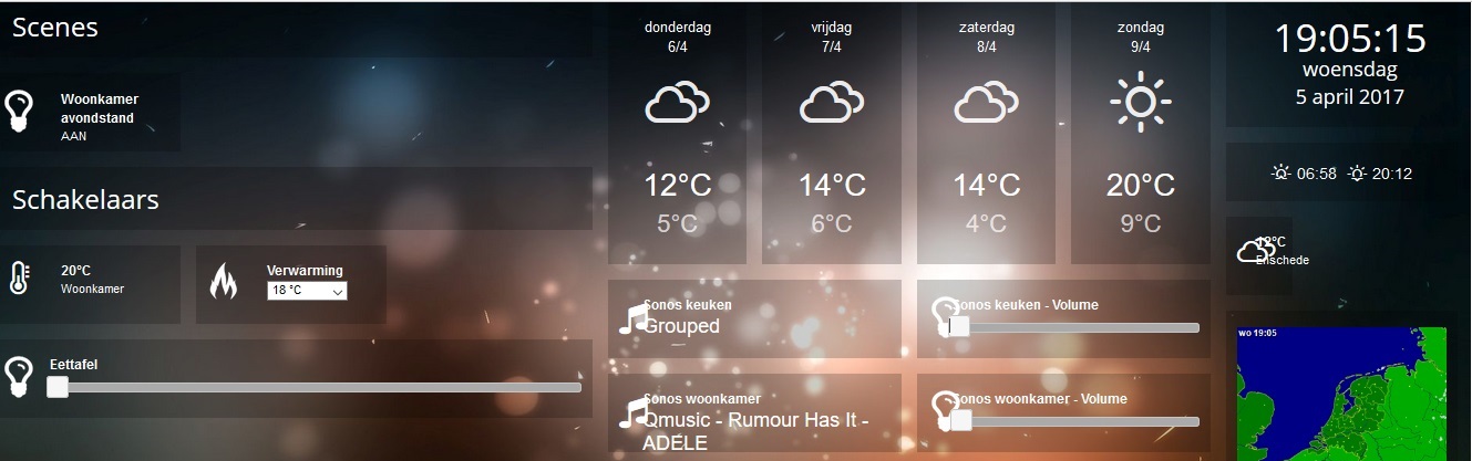

BETA BETA BETA
Want to test the latest version where you can arrange the blocks yourself?
Download the ZIP from (REMOVED LINK,VISIT GITLAB)
Copy the contents to a NEW SUBFOLDER, so do not overwrite your existing dashboard.
Copy CONFIG-DEFAULT.js to CONFIG.js and change according your needs.
You need to know the IDX of every device you want to show!!
You can create extra/less columns with a desired width and with the desired blocks.
Disclaimer:
Remember it may possible things wont work correctly so dont use it as your main dashboard.
Your wife/husband could get angry ;)
EDIT: BETA IS NOW IN GITLAB!
Last edited by robgeerts on Thursday 06 April 2017 10:07, edited 5 times in total.

robgeerts wrote:BETA BETA BETA
Download the ZIP from https://drive.google.com/file/d/0B3wQhk ... dON2s/view
Disclaimer:
You have left some personal data in the config_default.js. Your Wunderground API-key is still there ;-)

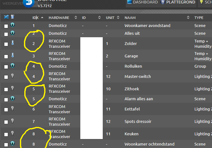

How can I manual add a scene? They can have the same IDX as a device.

Dynamic wrote:How can I manual add a scene? They can have the same IDX as a device.
I have to implement this, i'm thinking of prepend an S like:
columns[1] = {}
columns[1]['blocks'] = ['blocktitle_1',1,2,'s233']
columns[1]['width'] = 3;
(s233 would be a scene)

robgeerts wrote:I have to implement this, i'm thinking of prepend an S like:
columns[1] = {}
Looks good to me...

Dynamic wrote: I've been playing around and I love to customize the dashboard! However, I'm having some small isues with the icons. There are not correct positioned:
Should be better now!
BETA 3: https://drive.google.com/file/d/0B3wQhk ... sp=sharing
EdKo66 wrote:Not going to dive into this just yet. All those numbers are confusing me. Maybe I will give it a try next weekend.
I've just fixed that if you dont want to position every device, he tries to do this automatically, I added these variables (default=true) in the BETA-version:
var _USE_AUTO_POSITIONING 	= true;
var _USE_FAVORITES			= true;
SwordFish wrote: I really appreciate how quick you jump in the problems we send Image
EdKo66 wrote:Yes, I think Rob is doing an awful lot of work for us. Fixing problems almost as soon as we have send them.
Last edited by robgeerts on Wednesday 05 April 2017 21:41, edited 1 time in total.
