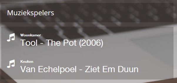

I'm getting pretty far with my own dashboard. An old iPad will be mounted to the wall next week to facilitate this awesome dashboard.
I've got a couple of devices that I would like to activate from the dashboard (switch command should be on/off or push). I will need this to controll my Sonos speakers. What is the easiest way to create a manual button and assign it to an on/off or push-switch?

EdKo66 wrote:Not sure if it's possible, but ..
I would like to control my Logitech Media Server (on Synology). Play/stop volume up/down, and on/off. Maybe even a playlist. It doesn't need to play on the site, iv'e got a Raspberry for that.
This triggered me to display whats currently playing (not controlling something yet) based on Domoticz data, screenshot of the new part of the dashboard:
Updates to main.js :
			if(!sliding){
					-------keep default code here ------
					$('#LMSPlayers').html('');
					for(r in data.result){
						if(data.result[r]['HardwareType']=='Logitech Media Server'){
							if(data.result[r]['Status']=='Playing'){
								var html='<div class="transbg">';
								html +='<div class="col-md-1 no-padding">';
								html +='<em class="fa fa-music"></em>';
								html +='</div>';
								html +='<div class="col-md-11 no-padding">';
								html +='<strong class="title">'+data.result[r]['Name']+'</strong><br />';
								html +='<span class="h2">'+data.result[r]['Data']+'</span>';
								html +='</div>';
								$('#LMSPlayers').append(html);
						------ keep default code here ------
update to config.js, addition to titles part:
titles.LMSPlayers = 'Muziekspelers';
and the index.html addition (I've kept the part on traffic and buttons as default and added LMSPlayers in between)
						<div class="row containstraffic mb">
							<div class="titletraffic"><h3 class="transbg"></h3></div>
							<div id="traffic"></div>
						</div>
						<div class="row mb">
							<div class="titleLMSPlayers"><h3 class="transbg"></h3></div>
							<div id="LMSPlayers"></div>
						</div>
						<div class="row mb" id="buttons">
Somethings wrong when using this on a small screen, the data is not displayed... I'm not an html expert, guess I've made a mistake somehere
Is it possible to add this to the repository?
edit: (improvement could be to show the playing status based on the Status field by coloring the icon green? and not hiding the titles?)
