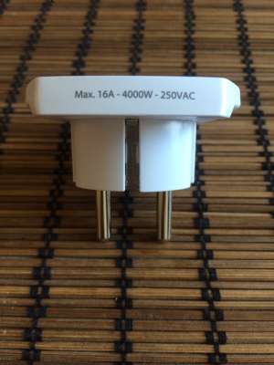

What kind of adapter is needed to be able to use the gateway in EU ?

burton666 wrote:I tried reading this thread but it is so many pages.
The cube, as it has six sides can I assign tasks to every side? like if I mark it out as a dice can I turn different lights on using all six sides?
How long would the wireless Xiaomi Aqara switch battery last?
Au of Chinese to eu

burton666 wrote:What kind of adapter is needed to be able to use the gateway in EU ?
For example "Skross"
