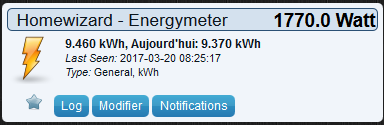

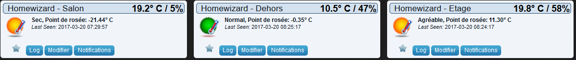

I let the script run for a complete day. Sadely, I don't have all infos from the homewizard.
The wattcher doesn't have the same daily consumption in domoticz and homewizard :(
And, thermometers doesn't refresh every poll.
2017-03-20 08_25_28-Domoticz.png (10.27 KiB) Viewed 4377 times
2017-03-20 08_25_39-Domoticz.png (21.69 KiB) Viewed 4377 times

Hi Brogen67,
I never checked the results from Homewizard and Domoticz but will start to do so ;)
The temp sensors are only updated when a value (temp or hum) changes, this is standard behavior and I think it should stay that way. I only changed it for the rainmeter since it doesn't often rain enough so it show red most of the time.
Updated to version 2.0.13

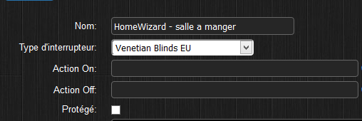

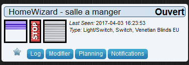

Just a little improvement you can do it's with the somfy blinds. It's better if there are "Venitian blinds EU" because you can stop them.
Wobbles
Posts: 27
Joined: Thursday 03 March 2016 19:30
Domoticz version: 3.8153
Re: Plugin - Homewizard
Post by Wobbles »
brogen67 wrote:Hi Wobbles,
I can change it but since I do not know the command to send to the Homewizard (if supported) it doesn't change anything. If you know the stop command please let me know and i'll change the switch.
Raspberry PI 1, Raspberry PI 2 & Raspberry PI 3, RFXCom, Z-Wave(Aeotec ZW090 Z-Stick Gen5), Philips HUE and using the premium android app
brogen67
Posts: 17
Joined: Wednesday 01 March 2017 20:20
Post by brogen67 »
For me, I just changed the type of my homewizard device, and it worked.
But, for the command it's :
/sf/0/down
/sf/0/up
/sf/0/stop

I have updated the somfy switch. Please let me know if it works as expected.
