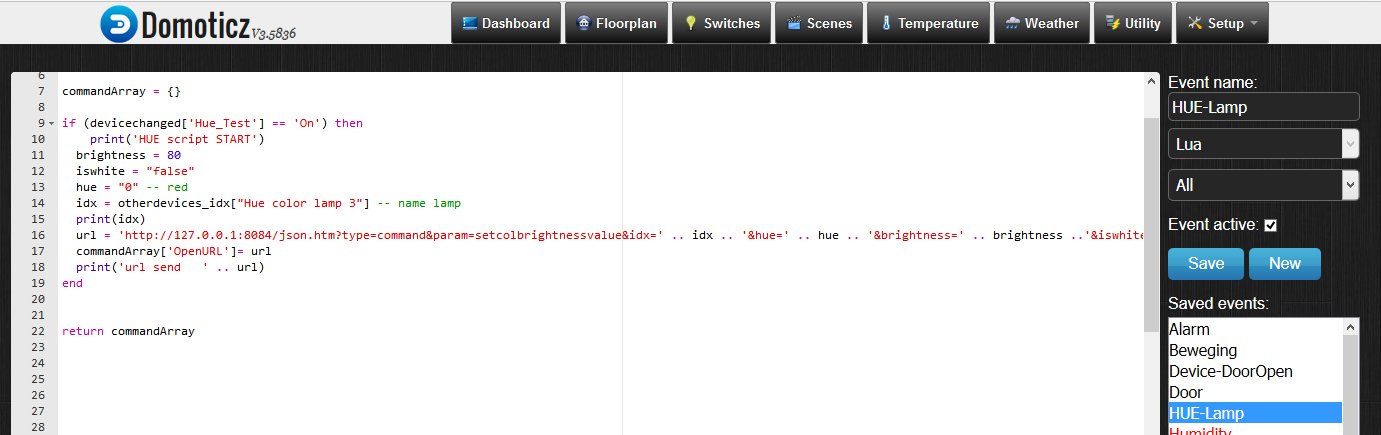

I hope someone can help me. I'm using the internal Domoticz Ace Editor to create my scripts.
As far as I could find out these scripts are stored in the database. So far so good.
At Switches, Groups and Scenes you can couple script actions.
I create my scripts with:
My question is how I can call these scripts because I do not know what to enter at: I tried to put in the name but that doesn't work.
help would be appreciated

First off all :
Change choice under LUA for device and record.
You made a device script.
He will run each time your switch who is call "Hue Test" will turn ON

I put you on the wrong leg. The script is just an example to show in which editor I make my scripts in.
I would like to know how i can call such a created script.
Do you know how to do this?
So lets assume I make a script and I call it bert in the editor
Then i would like that that script runs when I activate a scene
I doesn't work when I then call On Action: script://bert
I hope you or someone else know the answer.

script://script_device_HUE-LAMP.lua

You can't access the scripts within the database using the On / Off parameters for a Group, these expect either a path to a file or a web path.bertbigb wrote:Everyone thanks for the answers. Probably my question is not clear enough.
From a Group or Scene you can call a script for a On or Off action. There you have to fill in the path to the script.
When you use the script editor within domoticz the script is stored into the database.
The question is how you can call a script which is in the database for the On or Off action within a Group or Scene?
I hope I have made myself more clear with the above.
I think the best way to do what you want is to include a dummy on/off device in your Group (scenes can only be turned on / not off, groups can be turned on and off).
Then create a script which activates when the device is changed by the group being turned on or off, just ignore the On / Off actions in the Group / Scene settings.
So device called "Scene Dummy" then create a device script:
if devicechanged["Scene Dummy"] == 'On' then
-- place your on code here
-- place your off code here
return commandArrayRaspberry Pi 2 B - 2A@5V PSU - Raspbian + Domoticz + RFXtrx(89), LightwaveRF House(dimmers, sockets, wireless/mood switches), Owl CM113, 4 LaCross Temp / Humidity Sensors, 4 Siemens PIR, Smappee, Solaredge, ESP8266
