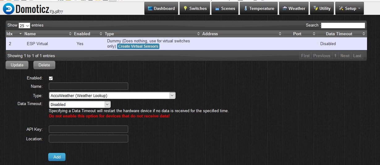

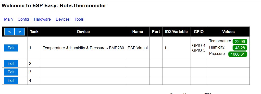

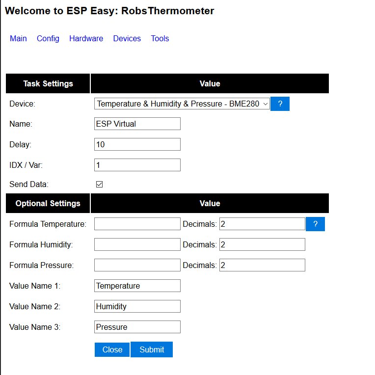

I'm a total beginner trying to configure my first ESPEasy BME280 (temp, humidity and pressure) device using an NodeMCU ESP8266. The ESPEasy and BME280 end seems to be working as I'm seeing good data in my EPSEasy Device "values" summary. However, I don't have the knowledge to get this data displayed in my Domoticz web-page. I've followed some guidelines and created a dummy hardware followed by "Create Virtual Sensors" which are visible but the associated data just isn't being updated from ESPEasy.
Have I missed out some critical step here? I thought that I didn't need to write any code to get this working but may be wrong on this. I think I've configured my ESPEasy device correctly (screenshot attached) but guess something is wrong somewhere.

Did you create the Domoticz dummy device as a Temp+Hum+Baro ?
You'll need to put its device idx into the IDX/Variable (unless it really is 1).

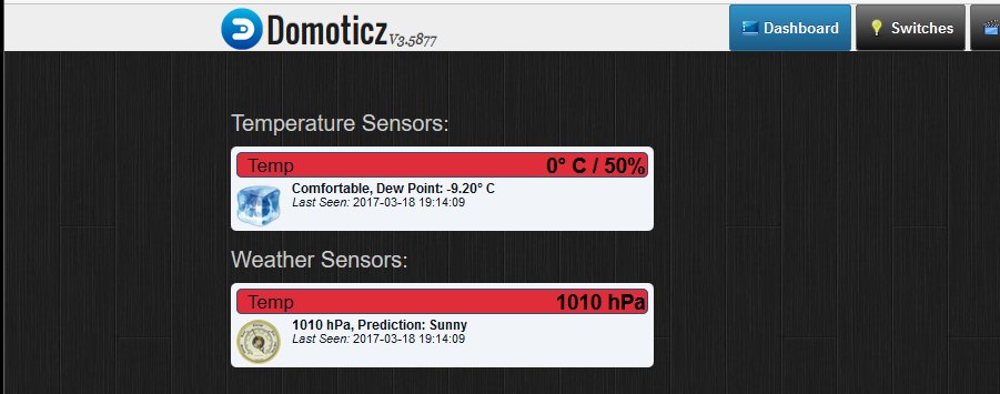

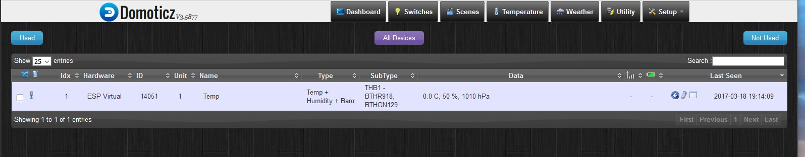

Yes, the dummy device is setup as Tem+Hum+baro (see screenshot)
The IDX really is 1 asd it's my first project (see Domoticz screenshots)

- Dashboard view.
- DomoticzDashboard.jpg (53.36 KiB) Viewed 5257 times
- Dummy h/w setup
- DomoticzHardwareDummy.jpg (104.43 KiB) Viewed 5257 times
- Virtual device setup
- DomoticzHardwareDevice.jpg (77.34 KiB) Viewed 5257 times

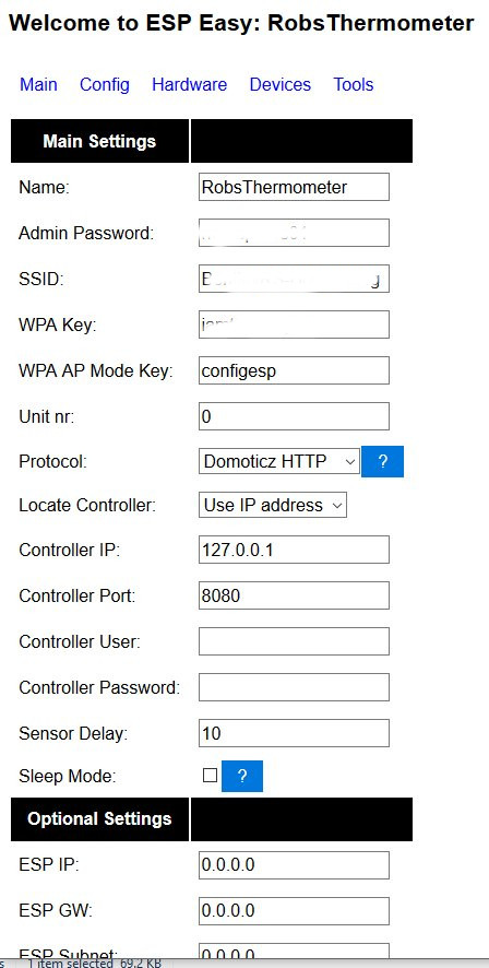

...and I've attched the ESPEasy device config showing Domoticz IP address etc that I'm using.
- ESPEasy Device config for Domoticz
- ESPEasyDeviceConfig.jpg (71.94 KiB) Viewed 5257 times

Controller IP, thats missing.
Or/and user and pass if You authorize in LAN too.

Yes, Controller IP needs to be that of your Domoticz machine.

Thanks to both of you for the pointer. However, I'm still unclear as to what info goes in the ESPEasy Config page. ...mainly as to which node it's referring to. i.e.
SSID/WPA Key: Is this the SSID of my LAN wifi modem or that of myNodeMCU access point
Controller IP: is this the NodeMCU IP or the IP of the PC hosting Donoticz web-server or the IP of the Donoticz web-server itself (i.e. 127.0.0.1)
Controller Port: Is this the Domoticz web-server (8080) or something else completely
As you can see, I'm really not sure how to set this up as I've never ever done it for an ESPEasy node before. so, please bear with me till I get this working and then I'm hoping it's pretty much the same approach for additional nodes.
I've attached more screenshots of my setup and tools log which, I hope, will help.

Got it. I just replaced the controller IP with the host name, and then set the actual host name with the name of my PC hosting Domoticz. Working a dream now. Sorry for the confusion. Now I have something that works, I think I csan repeat this for other nodes.

If you want to set the IP of your Domoticz you have to set it's external IP (127.0.0.1 is only accessible on the domoticz machine itself). The external IP of the Domoticz will most probably be something like 192.168.x.x
