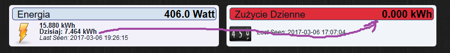

I have working Energy usage device (Dummy based on Pulse and ESP Easy).

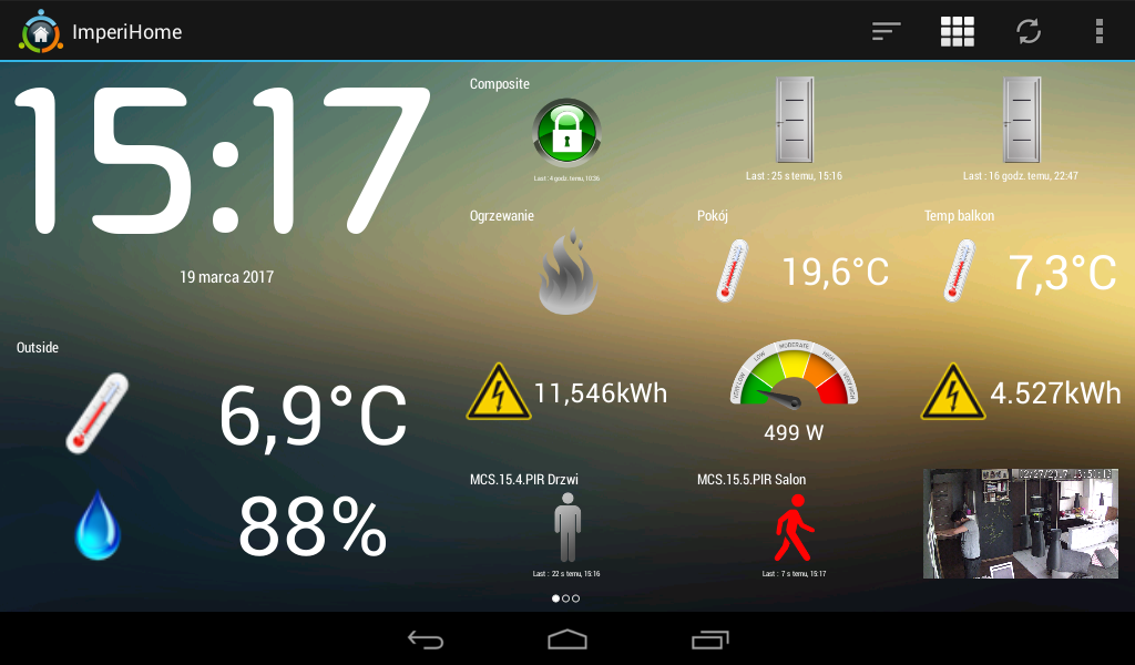

In my home system I would like to se in IMperiHOME my daily usage. So the shortest way is to create another device How in LUA can I take Daily usage from my first counter and put it to second "Daily" one?

Add dummy text sensor, take IDX
#!/bin/bash
data=`curl --silent -is "http://ip:port/json.htm?type=devices&rid=IDX" |grep "CounterToday" |sed 's/"//g' |awk '{print $3}'`
string="http://ip:port/json.htm?type=command¶m=udevice&IDX=120&nvalue=0&svalue="$data"kWh"
curl --silent $string
chmod +x filename.sh
* * * * * sh /home/pi/domoticz/scripts/daily.sh
ive made the same script which do the same every day at 23:55 and show me usage from last day (left usage is prev day, right 'this' day)
- Screenshot_2017-03-19-15-17-21.png (252.37 KiB) Viewed 5454 times
