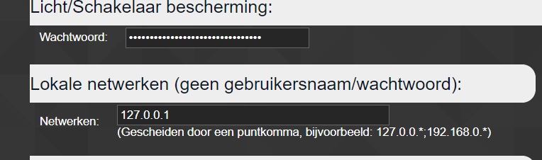

Well, I tried a lot but can't get Dzvents to work. Nothing happens. I already did the following things:
- Checked settings. (see screenshots)
- Tried the 'testscript' from the Quickstart wiki.
- Tried with a regular switch and a dummy.
Result is nothing in de logs. Only the confirmation of the saving of the script is written.
What am I overlooking?
please help this noob

You are on a very old version of domoticz. Can you upgrade?jellex87 wrote: Sunday 20 September 2020 14:21 Result is nothing in de logs. Only the confirmation of the saving of the script is written.
If not try to switch the 'niet actief' selections. I think I remember that something was not translated properly in this version but don't know for sure, which one (or both)

I'm using a Synology 213 NAS and I remember reading this is not supported anymore. Do you know what's the latest version I can use with my hardware?
Everything else works perfect...
I will try to switch the checkboxes of 'niet actief', but the Wiki says they have to be unchecked, so I did.
All other settings are good?

Sorry you will have to ask @jadahljellex87 wrote: Monday 21 September 2020 13:51 I'm using a Synology 213 NAS and I remember reading this is not supported anymore. Do you know what's the latest version I can use with my hardware?
YesI will try to switch the checkboxes of 'niet actief', but the Wiki says they have to be unchecked, so I did.

Finally I managed to got it working. I completely deleted the package and reinstalled the latest package available for my CPU.
I ran the test script from the Wiki and the logs let me know that it works.
Now going to learn some scripting...
