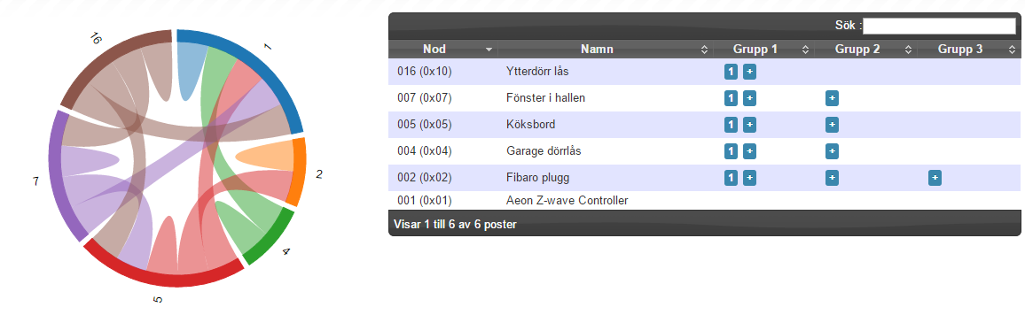

How can i get node 16 in the picture to go straight to node 1, and not go trough other nodes, and also exclude other nodes to be able to connect through node 16?
Node 16 is a id doorlock, and according to the manufacuturer i must make a straight connection to the aeon stick, and no other nodes can go through the door lock node, this is just to prevent the batteries in the doorlock to run out of power to fast.

You can't control how the mesh network builds up.
It's up to the manufacturer to indicate weither or not it's a routing device.

thank you for your answer, ok i will have to contact them again, so it is impossible to somehow control the routing, it is done automaticly?

Yep, automagically.

i have another question, as you can see in the picture above the nodes are named 1,2,3,4,5,7,16 number 6 was removed, and the gap between 7 to 16 was made when i tried to ad a switch that was hard to include, so i had to exclude it alot of times,that why the gap was made, but how can i get nodes nicely done, from 1,2,3,4,5,6,7,8? is it possible to rename them so that they get in order?

Node id's are sequential and count up from the biggest one. Hard reset the controller and include everything again is the only way to renumber them.
Shouldn't be a problem as zwave supports 255 nodes. What happens after that, I don't know. I hope they fill up the gaps then.
