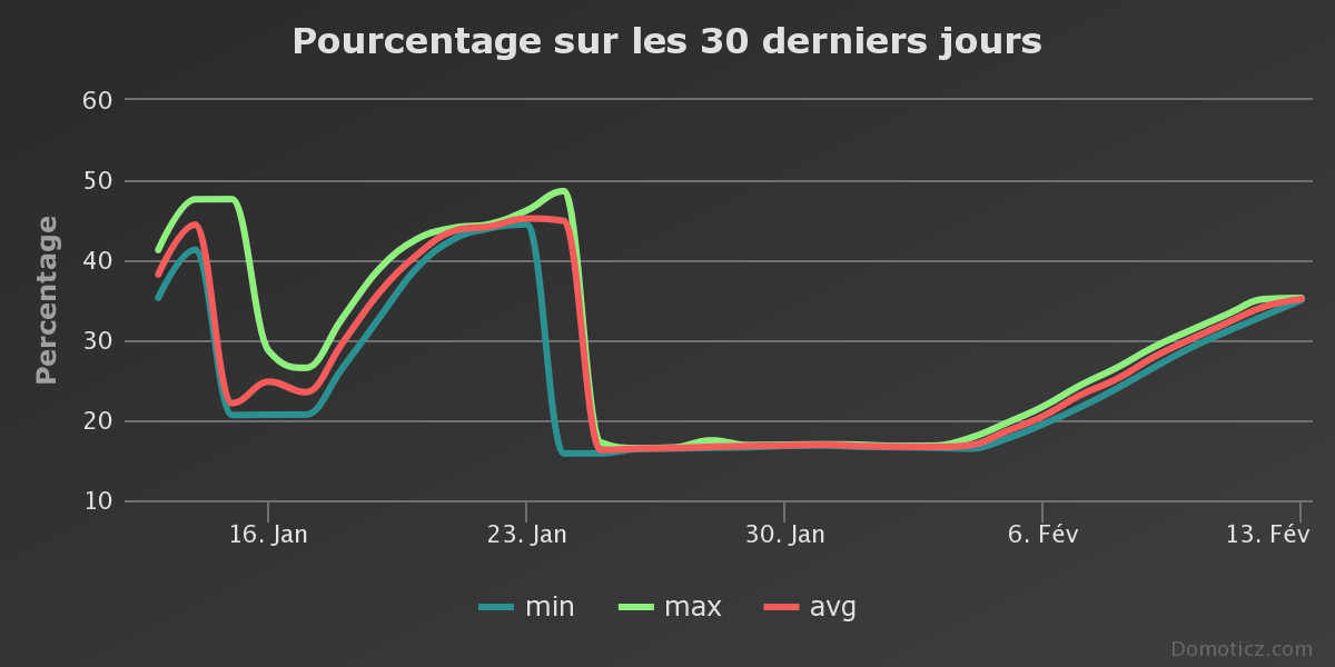

From years, i have a memory leak which need to reboot 1 time per month. Not a big deal. nothing in the logs.
I have decided to test by slowly deactivate all equipments, script (lua, etc.) and service.
I have detected that the source are in 4 blockly scripts. Set then inactive stop the leak.
I have two class of blockly scripts and 2 scripts in both class.
My blockly scripts are roughly all the same : they implement energy tuning consumption.

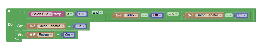

First class is : Test the temperature of a room (oregon) over threshold and if we are not in "vacancy" modes (virtual switch) or "turbo" (virtual switch) send a command to a DIO equipment to put on economy the electrical heat. (cf capture). I have 2 blockly script like this. Second class with 2 scripts is more simple and consists to test the temperature of the room and if the DIO equiment is ON (electrical heat) set the DIO equipment to OFF.
I am currently testing the two class of blockly scripts to be more accurate.
regards.

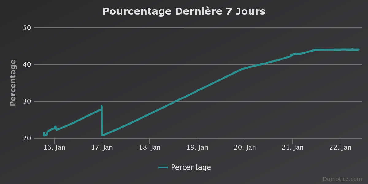

Blockly Script of class 1 have created the memory leak. I translated blockly into lua and the leak has disappeared. easy.

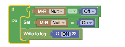

I only translate from blockly to lua keeping the commands to the DIO of course. The solution ran perfectly without leak (see Jan 25th-> Feb 4th). Then, i have tried to move back in order to handle the leak. Surprisingly, first results without virtual sensor (class 2) makes leak coming back (note it is in contradiction to first experimentation-class 2 scripts was supposed to be ok). I duplicate the same scripts (class 2) 10 times and leak don't increase. I did not understand
Blockly Scripts like if TEMP >=thresh and DIO(equip)=off then DIO (equip) =ON introduce memory leak on my configuration.
Keep running in lua only !

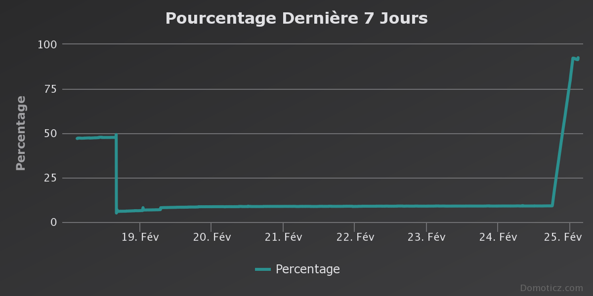

hello, finally i found. any blocks with blockly with commands introduce a memory leak. I have started to write some tests that set on and off sensor Two symmetrical scripts has been used . In 5 hours i have used all the memory of the PI.

I have a LOT of blocky's and run out of memory after about 7-8 days. Seems like it may be the same issue.
Have you made any progress? Did you report this as a bug?

Saw yr bug report. Replacing all my blockies with lua scripts ensured that the system is now stable at 3.6% mem use over the past 24 hrs. Normally, it would have increased by 10%.
