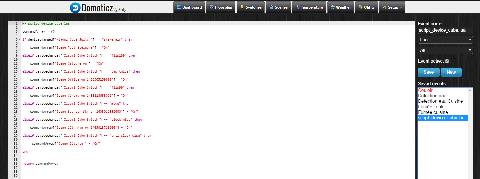

With this code (1) in web interface : all work well but I got this error :
2017-02-19 19:24:00.198 Error: EventSystem: in script_device_cube.lua: [string "-- script_device_cube.lua..."]:5: attempt to index global 'devicechanged' (a nil value)
When i put this lua script in /home/pi/domoticz/scripts/lua, the error disappear but the shake_air doesn't work : / (the other change work well)
Thank you !

I don't understand why the script on the interface work well, but not the one in folder :"/home/pi/domoticz/scripts/lua" : /
cube (2).png (136.34 KiB) Viewed 2519 times

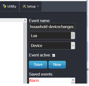

As this is a device script, you have to set your script to device and not to all, just under LUA string
Event Settings.png (11.01 KiB) Viewed 2441 times
Here you tell what type of script it is, like Dennoo writes not All but Device
I hope this pictures helps you to get it fixed
Best regards Bert
