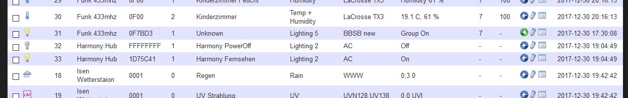

I copied the Harmony Hub and several devices from my old Logitech remote control.
I can control my devices on the iPhone, but Domoticz only finds two commands.
Harmony PowerOff
Harmony TV "Action"
I have activated the 5 minutes under Settings.
When I send a signal on the iPhone, I assumed that my domoticz would find and store the signal.
Can't I use my Vu+ Sat with the EPG or pause button in Domoticz?
Can't Domoticz access all commands from the Logitech hub?

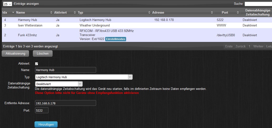

jluc2808
Posts: 49
Joined: Thursday 18 January 2018 6:30
Re: Harmony support, new hardware?
Post by jluc2808 »
Duan wrote: Thursday 29 December 2016 21:00 Hi All,
When I try to add my Harmony just like in the wiki, I don't see any fields to add a username and password.
I had this problem on the stable version 3.5837, but also on the latest beta version.
Does anyone else experience the same problem?
Kind regards,
Duan
hi , i just have the same problem, no field to enter id/pswd how did you solved the problem ?

Logitech made changes in the firmware of the Harmony... It will, for the time being, not work anymore.
Many users complaint about it to Logitech.. but afaIk they are not willing to revert it..
What you could do is to revert your firmware back..there is a complete manual on Reddit.com (search for Harmony rollback)
Regards,Hans

So...
I did install the firmware using the provided documentation (Thanks :) )
But I still don't have the login/password field in the hardware screen.
Any idea ?
EDIT :
Oh! My bad, it works anyway!!
