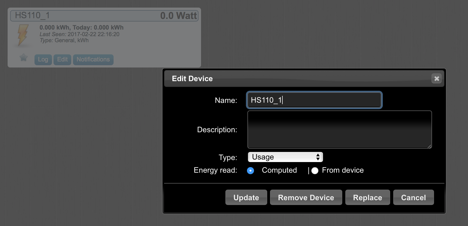

Can you explain how to do that? Because when I create the virtual sensor and put the script in /script/ I don't know what else to do.
Screen Shot 2017-02-22 at 22.22.42.png (216.54 KiB) Viewed 8076 times
