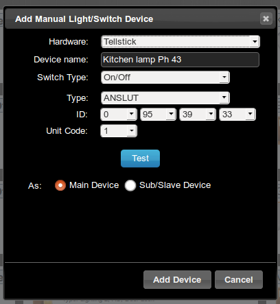

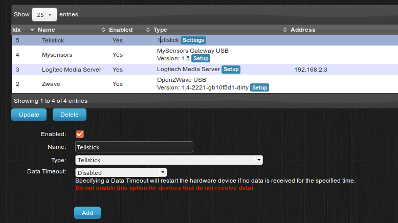

I am trying to get Tellstick working in Domoticz. And I am unsure which path to follow.
Tellstick is working via command line, amd I have added the tellstick in Hardware - no devices will show up in Devices.
I try to manually add in the switch upper left corner, Manual Light/Switch. I am not able to have the test to switch on my Lamp/switch
tellstick_CMD_ on.png (8.33 KiB) Viewed 3565 times
I can se that my lamp is switched on, CMD is working

And then I will add this lamp manually in Domoticz - but I am not able to switch the lamp on?
IS this approach wrong? and I should go and use the "old" way with dummy switches hat are executing shell scripts?

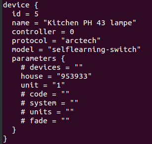

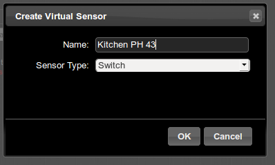

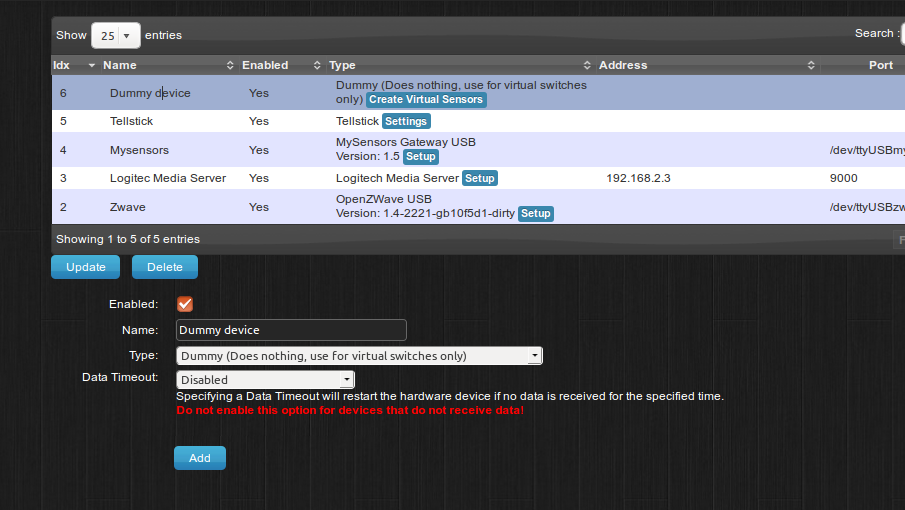

Create a dummy device: Setup->Hardware
Create a dummy device: Click on "Create virtual Sensors" and add a device name that makes sense for you. Mine is a Kitchen Pouls Henningsen 43cm lamp

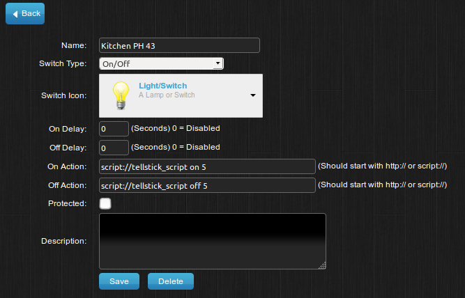

goto your "Switch" tab that contains all your switches, and search in the bottom at the page
Click "Edit" and add your stuff like I did (My device id is 5 in etc/tellstick.conf)
You shall use the device id that you have in your /etc/tellstick.conf

place this script here: /domoticz/scripts
 touch tellstick_script
chmod a+x tellstick_script
to create and make it executeable
My script:
#!/bin/bash
# Domoticz Script to execute tellstick commands via dummy device
# Created 2016,by Brian Jacobsen, [email protected]
# execute command like below, action is "on" or "off" device id is from etc/tellstick.conf
# tellstick_script action  device id
# example:
# tellstick_script off 5
# tellstick_script on 2
tdtool  --$1 $2

Then the script is used for all your Tellstick dummy devices, add a device switch for each device id that you have in your /etc/tellstick.conf (read: replace "5" with maybe "2" or "3" )

Is the only way to get Tellstick DUO support to use this Dummy hardware and Virtual Devices?
I use an RPI2
I downloaded the latest version of Domoticz
Downloaded and compiled Telldus Core. Telldus core works and I can turn on and off lamps using tdtool
I can also receive my sensors
When I start Domoticz and select add HW I can see Tellstick as an option, but when added I can see no devices. Shouldn't this list be populated from tellsick.conf?
