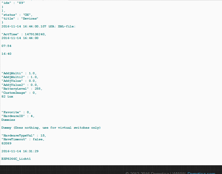

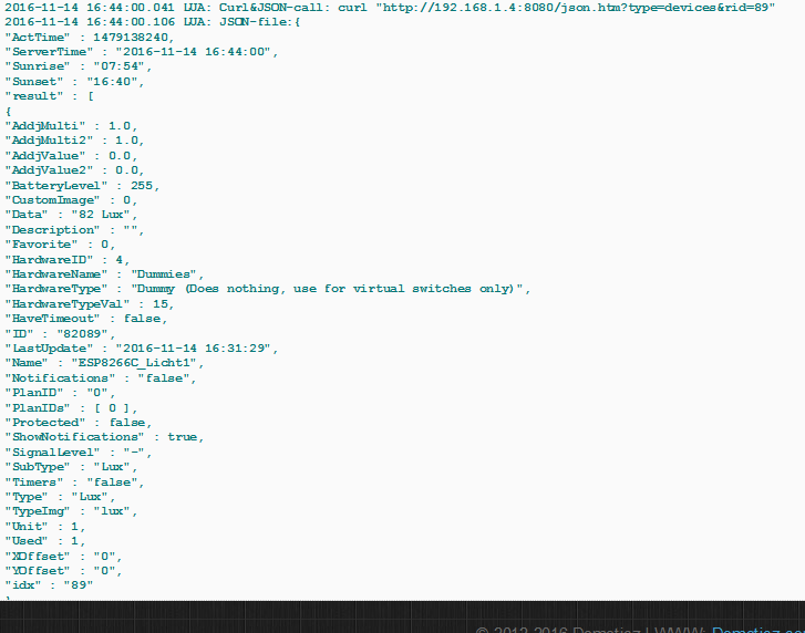

Started to make a lua-script (borrowing ideas and scripts from internet), and found a solution for the indicated step 1b), but now stuck at step 2):
the conversion by the borrowed script from JSON to XML produces a file which (euphemistically) does not meet the definitions for an XML-file.
The script is below, together with 2 related extracts from Domoticz's log.
Any ideas how to proceed?
Applicable, working examples?

J='curl "http://192.168.1.4:8080/json.htm?type=devices&rid=89"'
print('Curl&JSON-call: '.. J)
local JSON_Light1=assert(io.popen(J))
local Contents1 = JSON_Light1:read('*all')
JSON_Light1:close()
print('JSON-file:'..Contents1) -- Check contents of JSON-file

the elements can be recognized, but the required brackets and all headings are missing.
How to add those brackets and headers to the XML-output?

The compilation is input for the 'next stage' at the ftp-server which reads the json-file or the xml-file.
Therefore both json-file and xml-file, because not yet sure of the further application, and therefore 'freedom' required.
Consider this script as conceptual/example material, to be tuned & improved & expanded, especially looking at an application by the 'next stage'!!!
