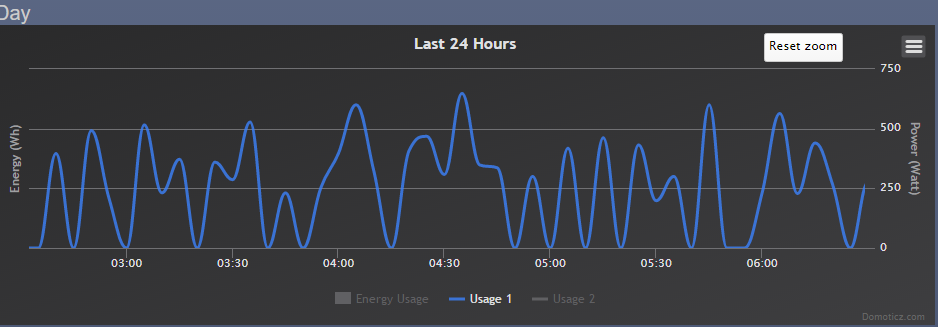

I am using the Eneco toon to monitor my powerconsumption by adding the P!. But for some reason it quite often measures 0Watt so the graph shows wrong. I attached a screenshot of the graph to show the problem. Does someknow know why it is measuring 0Watt so often or how to filter these result from the log?

Are you curtain that you are draning always more then 0 Wh? Need to look at the specifications again, but i believe its a sum over a few minutes depending on the update frequency of your Smartmeter and what is being sent to your Toon.Blueone wrote:I am using the Eneco toon to monitor my powerconsumption by adding the P!. But for some reason it quite often measures 0Watt so the graph shows wrong. I attached a screenshot of the graph to show the problem. Does someknow know why it is measuring 0Watt so often or how to filter these result from the log?
You can test for yourself by vacuumcleaning with 2000Watts for 15 minutes or use your dryer

I do have a ventilation system which is alway using energy. I do know domoticz is connecting with the webservice from the eneco to get thse values, maybe it has something to do with that. I also attached a screenshot from the graphic from Toon it self which isn't showing the 0 watt values (the reach from the graph is different but I never saw 0 watt on the Toon itself. So I hope someone has an idea to show the proper values.

I was thinking it was the Smartmeter. As Toon is showing it correctly, perhaps you need to query more times in a hour. Likes like your query is every 10 minutes.
Not sure where your data comes from: Eneco's Subscription Service or directly from Toon device. If its the later, try to increase it to 1 minute...

Oke, as far as I'm aware I don't have an option to increase the querytime. I've added the toon as a hardware device with the login details to my subscription, this result in a few hardware devices:
The power and gas consumption. So it seems like I can't edit that. I also see the Toon itself is refreshing every 10 seconds. Do you know if there is also an option to directly access the Toon to get the powerconsuption? Maybe that is a more reliable source.

I have the same "issue". Every 55 minutes I see a 0 Watt dip. It's not Wh; it's W. And I am sure that I am always using power. I have a ventilation system and my Domoticz runs on a Windows computer using about 90-100Watt constantly.
Let's hope as soon as Gizmocuz has implemented the Toon API this is gone.

I now replaced it for a usb P1 metering cable, everything works perfectly now. It has to do with the Toon connection.
