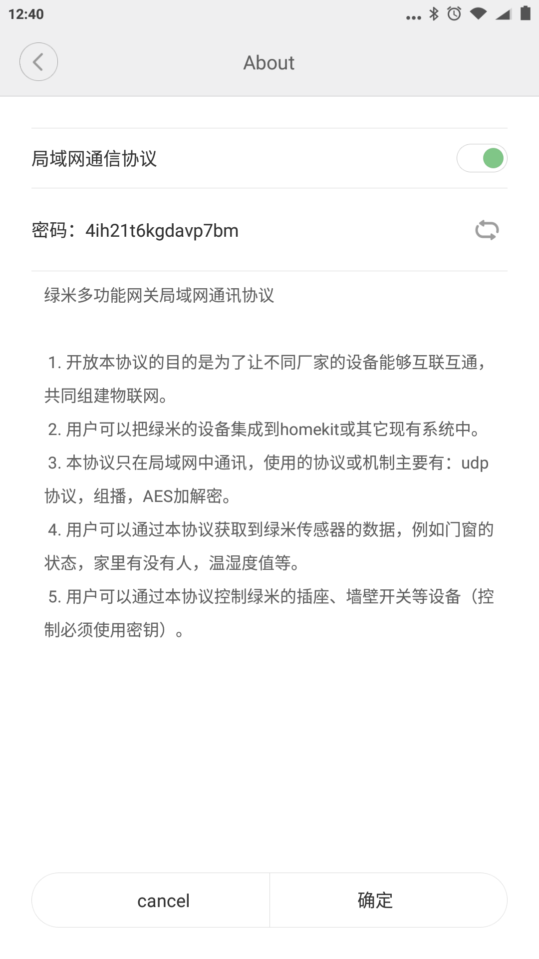

murtadin
- Posts: 62
- Joined: Saturday 31 December 2016 15:33
Re: RE: Re: RE: Re: Xiaomi Smart Home Suite (very cheap) compatibilty?
Password is set: 4ih21t6kgdavp7bmlevynger wrote:murtadin wrote:Code: Select all
2017-01-19 12:35:21.364 User: Admin initiated a switch command (16/Xiaomi Smart Plug/On) 2017-01-19 12:35:21.364 0117A188 2017-01-19 12:35:21.364 GetGatewayKey: m_GatewayPassword is 4ih21t6kgdavp7bm 2017-01-19 12:35:21.364 GetGatewayKey: m_token is 2017-01-19 12:35:21.364 GetGatewayKey: gatewaykey FE25EFFDA1230D157A1CF8D4E8A370B1 2017-01-19 12:35:21.514 XiaomiGateway: response {"cmd":"write_ack","sid":"158d000117a188","data":"{\"error\":\"Invalid key\"}"} 2017-01-19 12:35:21.514 (gw.living) Light/Switch (Xiaomi Smart Plug)
had the same problem, just found out that i was missing the Gateway password,
please make sure you set in hardware tab the gateway password as indicated in here:
https://www.domoticz.com/wiki/Xiaomi_Ga ... le_Devices
- Spoiler: show
mKotek
- Posts: 68
- Joined: Wednesday 30 December 2015 23:54
- Location: Poland
I would say, you are missing the m_token value, but this is only from your screenshot. I am still waiting for my Gateway to arrive, so cannot test it myself. If I am mistaken, please let me know, so not to produce useless posts.
