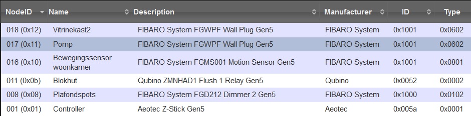

i have installed 2 new Fibaro FGWPF-102 ZW5 versions.
I have made new config files so the modules are recognized correctly
They work great, switching, powerconsumption etc everything is working.
Now i have 2 problems
openzwave control panel now seems very slow
before the modules were added and i clicked control panel all the modules would show up instantly.
Now they show up one by one which takes +/- 5 minutes
second problem is that the 2 new modules do not show up in openzwave control panel at the bottom.
if i click statistics i see all the modules(including the new ones) with al the info but the 2 modules do not show up at the bottom.
this is really a problem becauise now i can not force those modules to do a neighbour discover or other commands.
modules in domoticz
all the modules in statistics(so openzwave control panel sees them)
but openzwave control panel does not put them at the bottom of the screen
also the devices show up really slow.
could there be some leftovers from the old fibaro plug i excluded from the config
The old module was not zw5, the new modules are but they have different id's
as far as i can tell this problem was also there before i excluded a module
can this be the cause of this

Could it be that you are trying this in firefox?
I'm experiencing the same issue but it's not present when using Chrome.
EDIT: I fixed the issue. The problem was caused by an illegal character that was in the configuration. I'll upload the fix to the OpenZwave github.
Edit 2: In the meanwhile the change has been accepted: https://github.com/OpenZWave/open-zwave ... c3af1833f6

Wow YcKe you are a GENIUS. So an illegal character in the config file caused this
Which character because i do not see the change
I made that config file by editting the old fgwpe file so probably a strange typo
Also what should the type of the file be PC or UNIX
when i pull my files from the synology NAS the original files are type PC but i expected UNIX
changed the file and saved it as unix
Voila Zwave panel working again.(i will inspect my other modified files)

The word "device’s" was replace with "device's". As you can see the accent ' is from a different type. (non ascii)
This was causing the issue as firefox was complaining on it. I tried using chrome also and this one didn't have any problems with it.
Note: The next check-in of the OpenZwave team was to remove all non ascii characters in all config files, so it was not the only config file having problems.
Greetz YcKe
