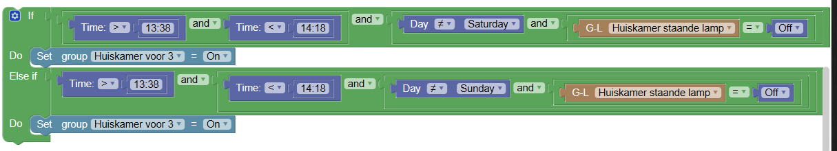

I will set lamps group on at moday till friday on at a certain time, (not in the weekends) and when off
if on yet norhing may happen
My logics in blockly were:
 if on certain time and its Monday till Friday and groups is off then do group on
nothing happended :lol:
little help if possible
thnx !

edje1205 wrote: My logics in blockly were:
If for some reason events skip a beat and miss 11:37 it will not trigger, to build in a safety you could put it between timeX and timeY
In your case it will also only trigger if none of mentioned lights are on (but I guess you know that).

@edj1205,
Also note you have used an If, else if, block (with the blue symbol in the top left) but without an else if. For this situation you should use the single If block without the blue symbol. ;)

Oke maybe the first attachement was a little bit blurring and over the top
I tried in another way see att
without the last 'and' (huiskamer staande lamp = off) it runs, so now I split it off in if's and else if's
but the last 'and' frustrate it.
set lights on if 2.png (40.12 KiB) Viewed 5408 times

the last 'and' in every line is one level lower as the other 'and's. that could be a problem.

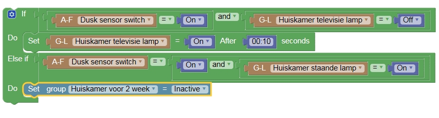

at least i got my Kaku dusk sensor abst-604 recognized in domoticz :)
Now I want:
A) My lights go on different times in week daily (some later) and weekend (some earlier)
But It could be grey/duskey outside so when its dark enough the dusksensor has to start
BUT
not running as A) is active because my lights go dimming down/up
see my blockly but it does nothing
(when I click on dusk sensor and have a light connected with it with the sensor setup it goes on/off. there are no devices connected with it)
thanx for suggestions !

edje1205 wrote:Hi
Now I want:
BUT
It does not trigger because it's incorrect ;)
Don't use the time (00:00) blockly for indicating seconds/minutes and mind the place where you put the conditions the [x = On] block has to be in 1 block... not seperated into 2 (I marked the part which is wrong).
Try this:
If [[[Dusk sensor switch] = [On]] and [[Huiskamer televisie lamp] = [Off]]]
Do [Set [Huiskamer televisie lamp] = [On] After [10] seconds]
Else if [[[Dusk sensor switch] = [On]] and [[Huiskamer staande lamp] = [On]]]
Do [Set group [Huiskamer voor 2 week] = [On]]
mind the brackets!
Groups switch on and off, you don't set them active/inactive (I'm not even sure when to use the (in)active option)
