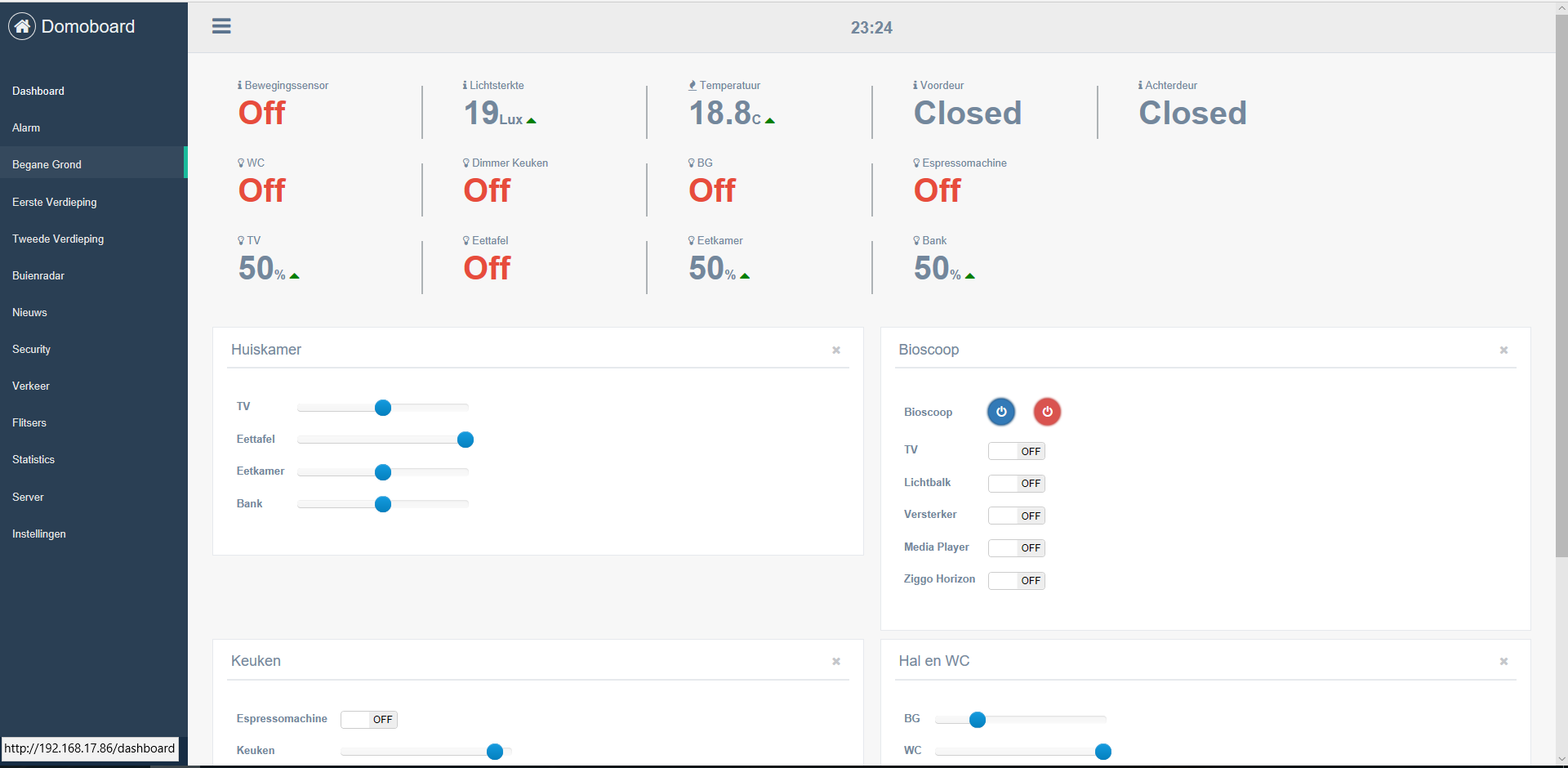

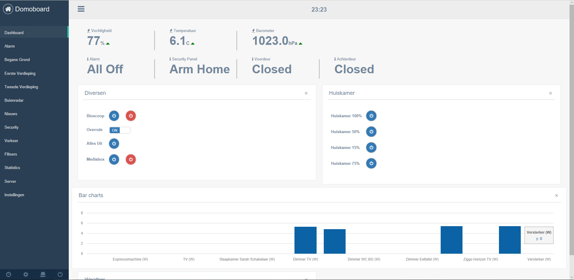

This dashboard looks very very nice. I was waiting for something like this. So I started right away and experimented a lot.
Here are some screenshots.
I have a few suggestions:
  • The dimmer slides suggests that the lamps are on. There is no difference between dimmers that are on or off.
  • In the top bar it's possible to show the time. Also it would be nice to have the date and weekday, and the status of the security panel.
  • Can we have a security panel for disarming/ arming?
  • The bar charts shows the name the device has in Domoticz. Also the name is too long, perhaps we can put the text in an angle?
  • The list in top_tiles, bar_charts, etc. is not sorted exactly like the config file.
  • Can we configure more than 2 switches windows next to each other?
