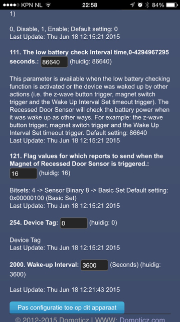

You should set the report type to 16 (setting 121)w

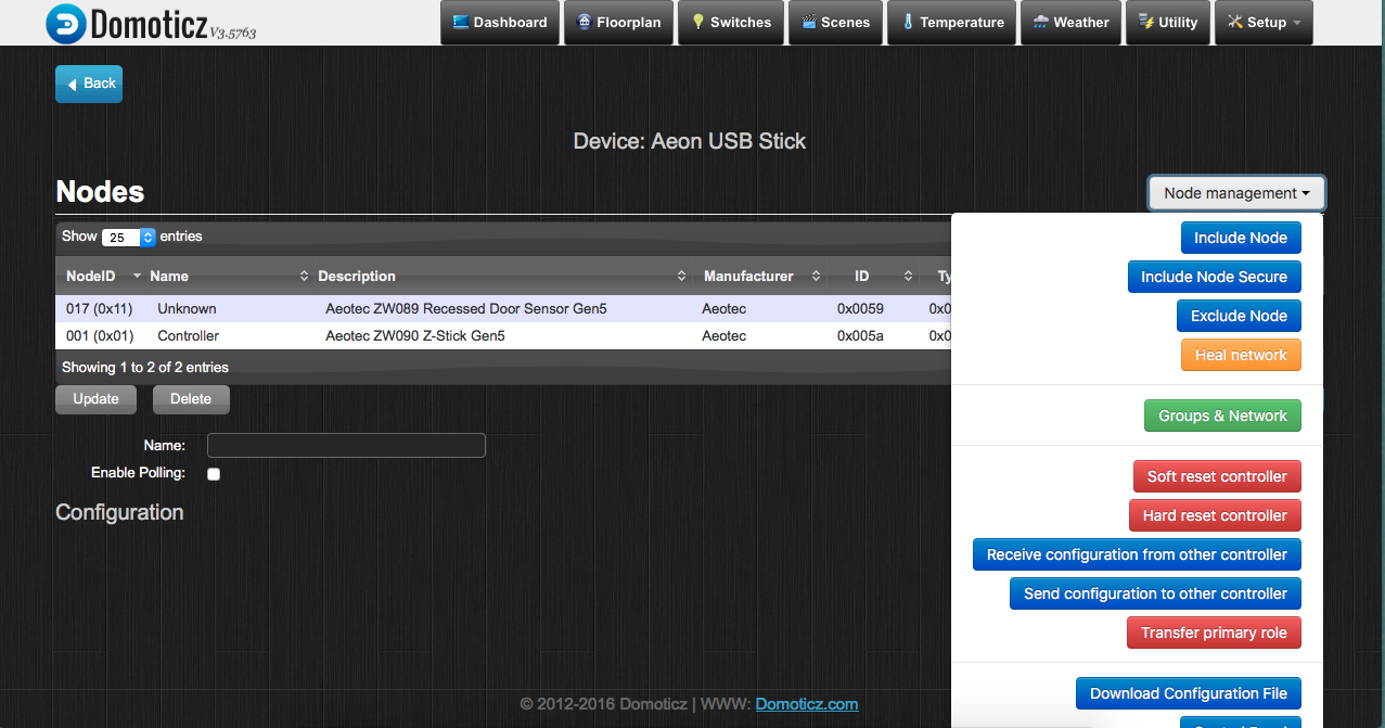

From the Nodes page, I can click the 'Node management' button and 'Include Node' to add the ZW-089 sensor by clicking the internal button on the door sensor with a small pin. Both 'Include Node' and 'Include Node Secure' work. The red light on the sensor blinks a few times quickly, remains red and then turns off. When I bring the magnet close, it responds.

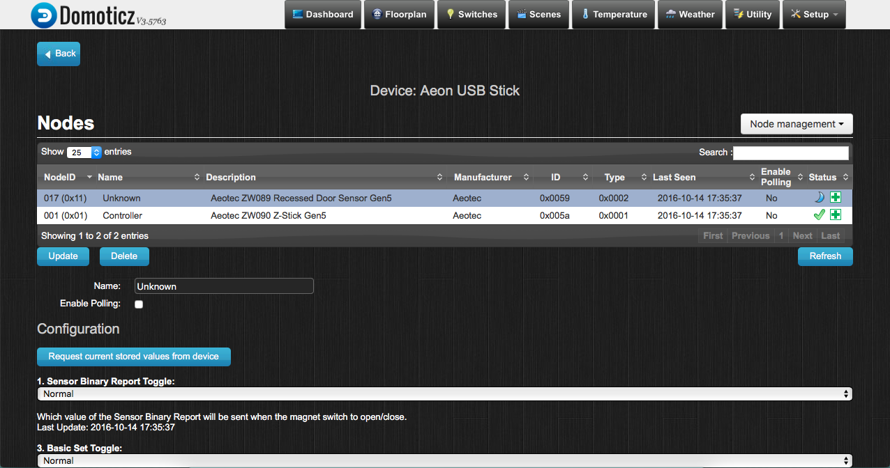

To get the sensor to actually work, you need to change the settings. This can be done by clicking the line in which the sensor is mentioned
Screen Shot 2016-10-14 at 17.39.27.png (305.1 KiB) Viewed 3654 times
I used the following settings:
1. Normal
2. Normal
101. Disabled
121. Sensor Binary Report -> This seems to be important because the Basic set did not work for me. Both Basic set and Binary report could also work.
252. Unlock
254. 1 -> Not sure if it also works with 0.
2000. 0
Apply configuration for this device. If this does not work or your sensor is asleep, you can wake it up by pressing the internal button with a pin.
